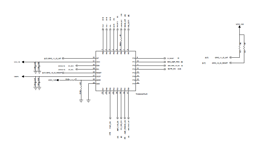

1. VCCI is powered by external LDO, while VCCP is powered by system VSMPS (1.7V). What is the scope of power ripple that VCCI and VCCP need to meet respectively?
2. What is the normal working current and peak current of VCCI and VCCP?
3. Do the power supply of VCCI and VCCP need to be normally turned on? What is the leakage current in the normally turned on state?
4. Are other devices connected to the I2C control line affected?VSMPS (1.7V) is used to pull up the chip end, and the pull up resistance is 2.2K
5, INT and RESET connect to the two GPIO ports of the chip, do you need to pull up resistance, pull up resistance is generally designed for what?
6. When using P00 to P27 for GPIO, can each port be independently configured as input or output, not associated with other ports?When used as input/output, is a pull resistor needed?
7. ADDR generally selects pull up to 1V8 or ground processing by default?
    [Bobby] INT is an output, if you don't need it you can leave it floating. RESET can be tied to Vcc with a pull up resistor. Higher value resistors provide lower leakage but weaker biasing. Generally 4.7k or 10k pull up resistors can be used.

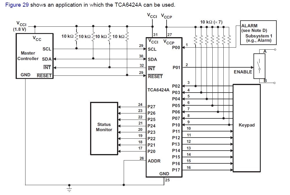

    [Bobby] each p-port pin is independent. Any pin set as an input should be referenced to either GND or Vcc with a resistor.

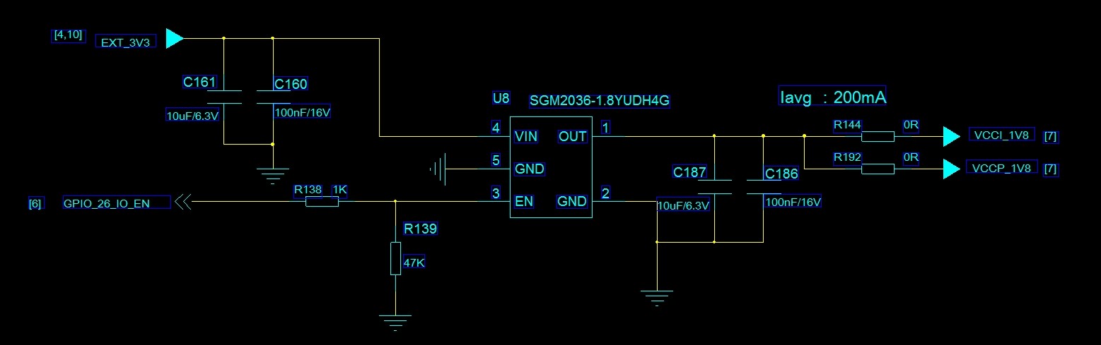

  • 1. The VSMPS power supply current of the system is insufficient (TYP100mA), and the current design is modified to supply power to external LDO.Is it possible to use an LDO to power BOTH VCCP and VCCI

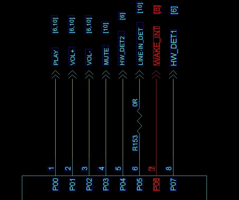

    2. P06 is designed as WAKE_INT. The use scenario is that after the speech wake-up word is recognized, the wake-up chip sends out interrupt signal, and then the interrupt signal is fed back to the main chip

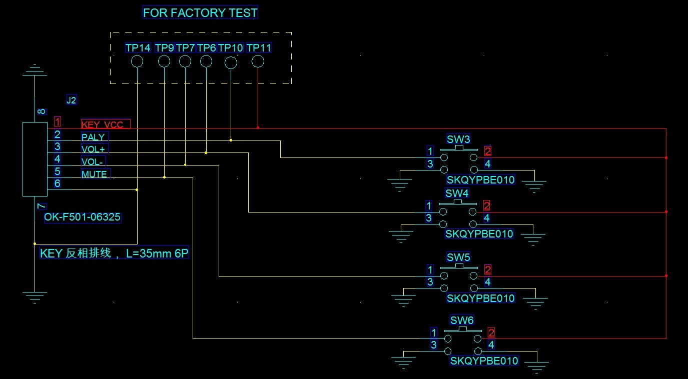

    3. When using the keypad function, it is necessary to initially connect VCCI to pull up. After pressing down, the low level is effective
    [Bobby] Using an LDO to power VCCP and VCCI is not a problem.
    [Bobby] I'm assuming here, you mean that P06 is an input. And when it sees the pin change state, the main INT on the device will assert to the main chip=processor.

    4. When PIO is designed as GPIO port, as input, whether external VCCI or GND reference level is required
    [Bobby] It should be referenced to either GND or VCCP with an external resistor (10k or 4.7k will work).
