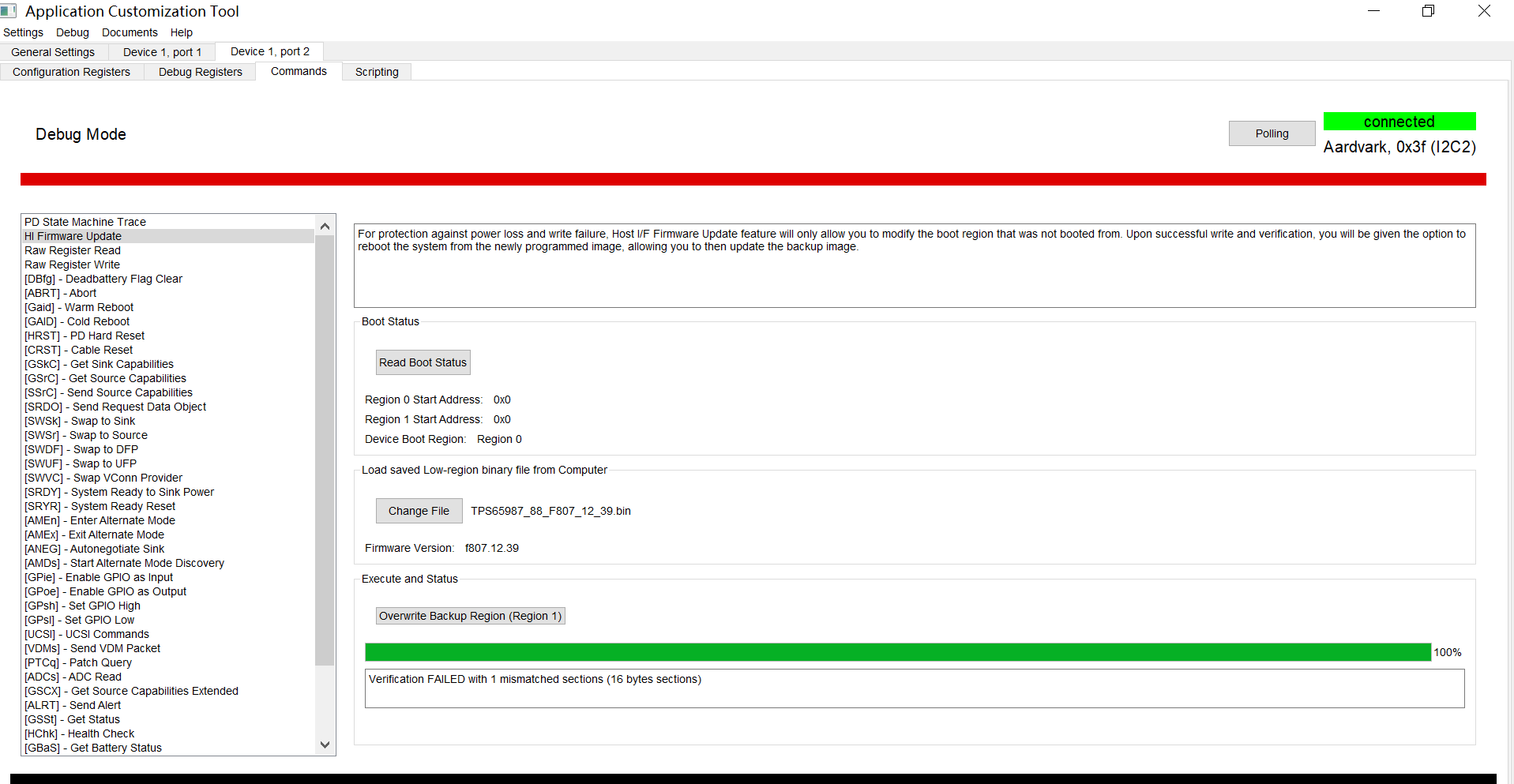

I check with TI “TPS65987_8_ACELITE_KRATOS Application Customization 6.2.8_RC2” GUI tool with Aardvark I2C tool to enter the debug mode, and it check the chip in the APP mode, and the PD state machine can sense the plug and unplug action, but the power path switches are off. So there is no power path to the VBUS, and check the CC logic, one pin is still communication, the other CC line is off, [low state] for CRB, the other line is 5V.
I have checked the hardware design with CRB, there seems no difference. So my question is , what should I check the hardware error which leads the abnormal behavior of the PD chip.
I have done another experiment, remove the TBT chip , only the PD chip left. The PD chip still not work normally.pf-cZ370-tbt.zip
  • i have checked the firmware version information: TPS65988 HW0030 FWF807.12.00 ZAce1

    Looks like no valid patch is running in the device. May I know the fw version that you are using and how you are downloading the patch to the PD Controller (via I2c or from spi flash). You can verify the FW version in debug mode.
    Prajith
  • this is the  firmware version read from the device by the the GUI tool: HW0030 FWF807.12.00 ZAce1 [i2c 0x38]

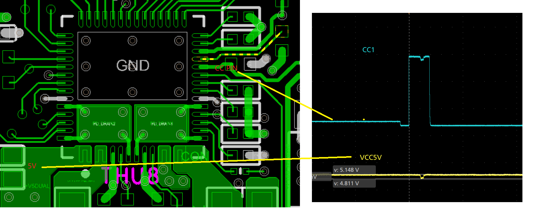

    i have attched the waveform of the CC pin when plug type C devcie.
    as you said, which debug register should i check? to know if the right patch is downloaded successfully.
    i have checked the layout witht he CRB, one different is the PP_cable pin, i add 0402 0 resistor on the power path, and the trace is a little slim, is that the cause of the fail CC communication? from the waveform, the CC can not boot to 5V normally. there is a drop in the 5V to the PD chip, i has added one bulk cap, but useless!
    Please test with the bin file attached. I hope you have an external SPI flash on the board to flash the patch bundle. You can refer the online training materials if you need any help on patch download using GUI - https://training.ti.com/tps6598x-application-customization-gui-tool-basic-introduction?context=1140344-1140206TPS65987_88_F807_12_39.zip
  • Prajith,
     thanks for your feedback, i have used the GUI tool update the patch code, but it seems failed please refer to the attached pic.
    I have checked the bin file i have used,it has the patch code in the low region.its version is F807_12_40, newer version than yours.i attached it too.TPS65987_88_F807_12_40_low region_full.zipcml-s-crb-tbt-titan ridge-tps65988dj-bkup-bin-20200413.zip
    I used the same bin on the intel comelake-s CRB, it works well. and my design leverage the intel CRB with the same bin, but it does not work normally.
    have you reviewed my design file? i think it probably hardware issue, not the firmware's problem, but i can not find the root cause.
    I took a look at your design file and it looks good. The issue you are facing is associated with patch loading. First step should be verifying successful patch download to SPI flash and boot from SPI flash. Download default host template to SPI flash and monitor SPI lines to see if the PD controller reads patch bundle from the external SPI flash. Use GUI v6.2.7 and FW v39 for this experiment. If this experiment is not successful, please share the procedure that you follow to download the patch.

    i have re-check the layout, and find the trace to PP_CABLE is 4mil, i am not sure if this will limit the current of the PP_cable from switching to CC line.
    when CC line communication, i can catch the voltage Drop on 5V to PD power pins. it is abnormal. could your help check the layout?i attached it.

    PP_Cable pin is for supplying power to Vconn. To isolate the issue further you can try with a non-EMCA cable. When you say "when CC line communication, i can catch the voltage Drop on 5V to PD power pins." do you mean Vbus is dropping? Could you share PD trace ?
    Please note Vconn is not required for non-emca cable. Use non-EMCA cable for your tests if you are worried about the PP_Cable trace width.

    Could you connect 5K resistor b/w CC and Ground on your board? I expect 5V on the Vbus. Please let me know the test result.
    One more thing, please fill some value in the customer use field and check whether you are seeing the same value in debug mode. This is to check whether Patch configuration is getting loaded correctly.
    Prajith
  •  the root cause for the vbus not work is found, it is the vbus schottky diode ,which is reverse assemblied, which leads to vbus forward to GND.
