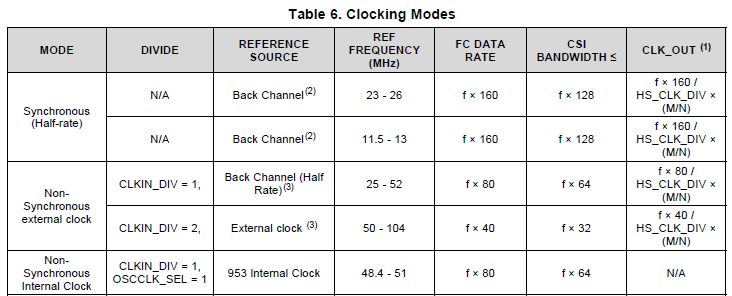

1. I would like to Know that if I am not using clockout of serializer whether I can use synchronous or non synchronous external clock mode?
2. Whether there is any limitation in using serializer and deserializer as shown below. Especially I would like know whether my serializer 2 will support a 1MP/60FPS (12bpp) data on 2 lanes in non synchronous internal clock mode?If not if I am replacing serailizer 2 with DS90UB953 whether I can use the below configuration?
3. What is the maximum CSI 2 data rate at one lane of DS90UB935-Q1 serializer in non synchronous internal clock mode? Is it 1.632Gbps/4 = 408Mbps(25.5MHz *64 = 1.632Gbps Ref:Datasheet Table 6) ?
