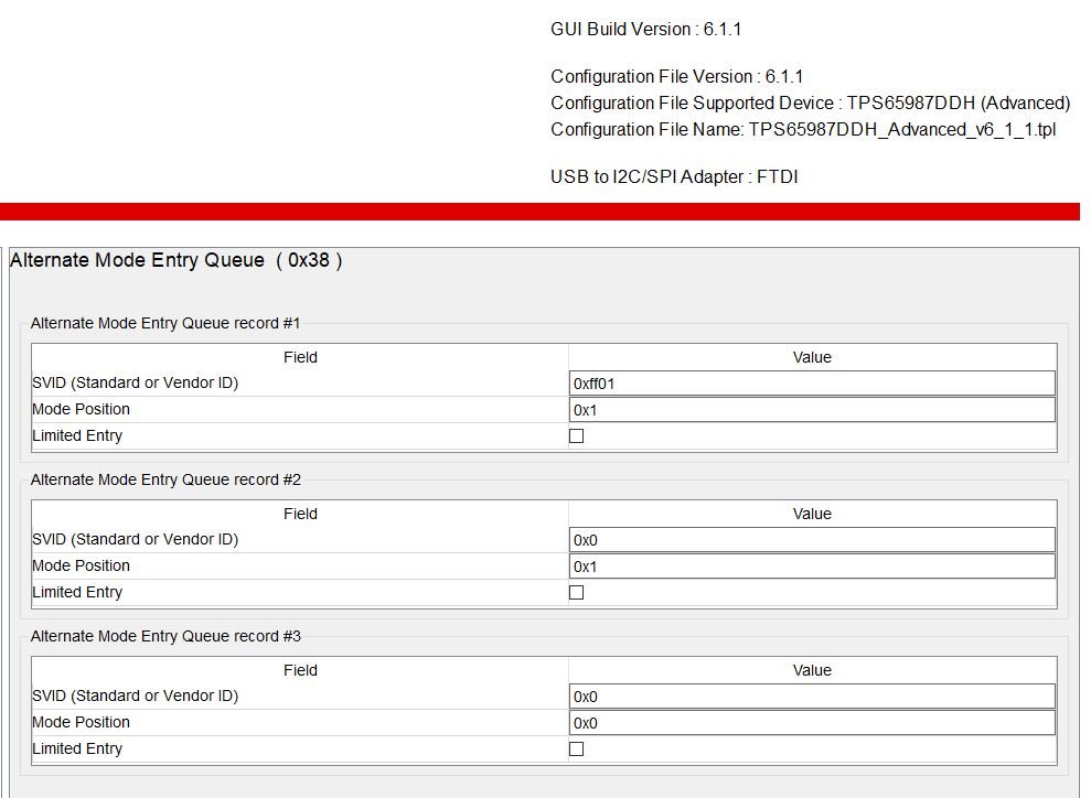

Part Number: TPS65987D
How can I use the tool to configure 4 SVID entries? The tool only allows 3 but the part itself, according to the datasheet allows 4.

Let me check with the team on this discrepancy
After checking with the team, this is an issue with the GUI and will fix it in our next maintenance release.
