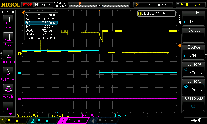

    I was able to have /RE, DE working simultaneously but when interfacing with device I still see an issue that response is delivered but it's not right.
    Basically I'm trying to read input status from device :
    with this bytes: [01][02][00][00][00][04][79][C9] which I see on A line
    then response should be something like [01] [02][04][00][CRC] but I'm getting randomly:
    <00><00><01><02><01><00> or <00><01><02><01><00><A1><88> which seems to be kind of OK but first byte is invalid.
    I contacted device manufacturer and they use some AnalogDevices RS485 transceiver and wrote me that maybe transceiver are incompatible which is unlikely.
    On scope I see following when TX is done and we start RX:
    Can this small glitch cause an issue? It's when DE/RE goes down. Also data on RS485 looks OK but what I receive on RX pin is what was posted above. Any idea what to check or adjust? How does signal should look like when TX is finished and we start RX? Thanks
  • Hi Marek,
    I'm glad to hear you've made progress!
    I agree that an incompatibility between RS-485 transceivers from different manufacturers is a very unlikely explanation.
    Which signals are shown in the capture above.  I believe the blue one is probably DE.  Is the yellow one R?  If so, why would it be toggling during the first part of the capture when DE is high - I thought /RE and DE were controlled by the same line?
    Anyway, the yellow signal looks like something that has been disabled and is therefore decaying in voltage to some steady-state bias point.  This could happen on the R output when /RE is high.  This can be problematic since many serial communications protocols detect the high-to-low transition as signaling the start of a word or frame.  So, in order to avoid falsely detecting this glitch as a start bit the solution is usually to place a pull-up resistance on the "R" output.  Something in the 1 kOhm to 10 kOhm range is suitable.  This keeps the voltage high whenever the output is disabled.
    If the yellow trace is the A or B line, it would be good to look at the differential signal when this happens and compare it to the differential input thresholds of the transceiver.  There could be a similar phenomenon here where a disabled or high-Z state results in something that can be interpreted as a "low" level, and this would be incorrectly interpreted as a start bit.  The solution here would be similar - that is, you would provide some positive differential bias to the receiver input by pulling A high and B low.  (You could read more about this here: https://e2e.ti.com/blogs_/b/industrial_strength/archive/2016/12/06/rs-485-basics-two-ways-to-fail-safe-bias-your-network.)
