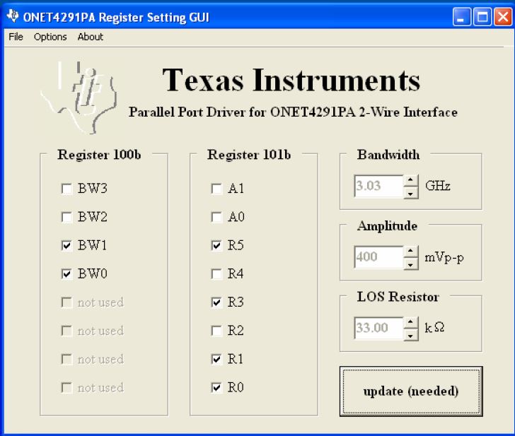

  • Hi Ryan,
    Both ONET4291VA and ONET4291PA use the same core block for I2C interface. Please note page 7 of the ONET4291VA: "The ONET4291VA has power on reset circuitry which ensures that all registers are reset to zero during startup. After the power-on to initialize time (TINIT1), the internal registers are ready to be loaded." Also please note in ONET4291PA page 10 especifies 800mV "selected(default"). There used to be a GUI for ONET4291PA which enabled 800mV. Please note GUI image - which is no longer supported - below. This enable the user to select 800mV or other VODs.
    Regards,, Nasser
