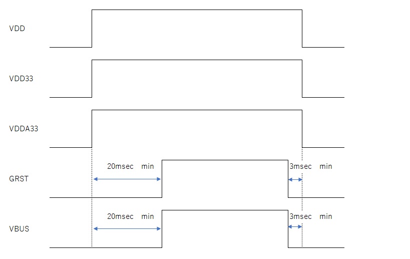

Part Number: TUSB9261-Q1
Hi Team,
I have a question about power, RST, VBUS sequence.
The power on/off sequence is controlled at the following timing.
Is there a problem?
