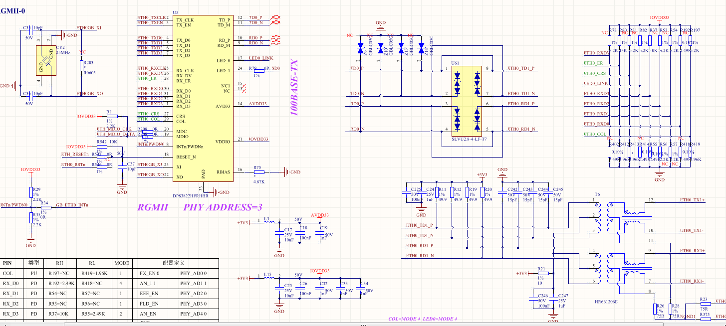

  • Hi Vikram,
    The ID=0x03. There are 4 PHY in the bus, the other three ID are 00 01 02 and can be read by AM5726. Only ID=0x03 cannot be read, the pull-down and pull-up resistor value are below,
    D0: RH=2.49k, RL=NC
    D1: NC, NC
    D2: NC, NC
    D3: NC, NC
    I detected all strp pin voltage and it meet the target in our datatsheets.

  • Hi Vikram,
    The power-up sequence matches what is recommended in the datasheet. The customer used crystal. You can see the schematic below.

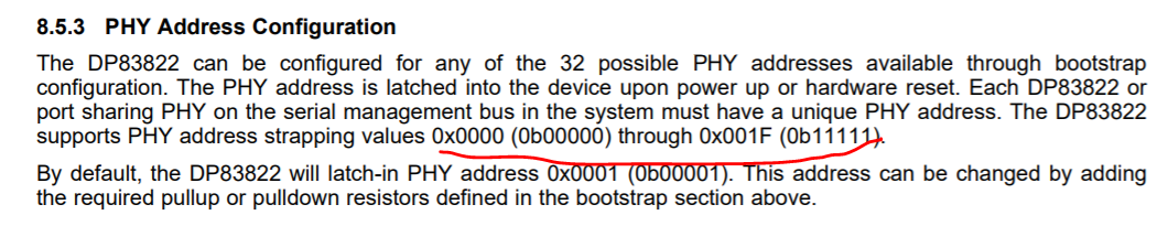

    Yes it is strange if other phys are also 822. So other 822s have phy address 1 and 2? (as 0 is not the supported address) . I am not aware of any issue with phy id being 3 but can we do following experiments.
    =>  Power down other phys so that they dont interfere on MDC/MDIO lines and then try addressing phy with phy id 3.
    Vikram
  • Hi Vikram,
    PHY ID should be supported by DP83822. The method you recommended here has been tried by us, the result is the same. What other methods you can think here to solve this issue? Thanks.

  • Hi CL,
    Yes you are right. I assumed default value (without any strap) as the minimum phy id address.
    One more thing I can think of is changing phy id of the non-responding phy from 03 to 01 (to see if there is problem with particular strap setting itself). Have you already tried this also?

  • Hi Vikram,
    Thank you for your response here. The issue is resolved by adding a 22ohm resistor in serial in the MDIO line. This is very strange for me to understand, for we change the CLK frequency to a slower speed before but it cannot solve this issue. Would appreciate it if you can share your professional experience here. Thanks.
    BR,
    CL
  • Hi Charles,
    Yes it is strange. Did the customer share some waveforms of MDC and MDIO with and without 22ohms? Was this 22 ohms recommended by MAC side ?
    Is this 22 ohms has been placed only for phy with phy id 3?
    It will be very interesting to have a look at the layout of MDIO traces for these 3 phys.
    Let us know what you find and it will help us to capture this as possible solution for similar used layouts/MAC.
