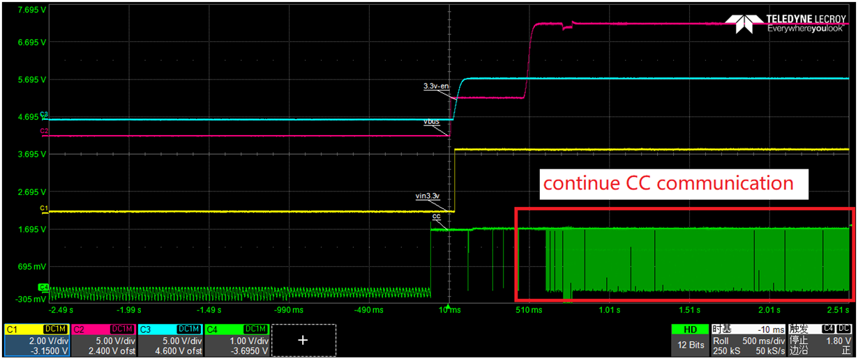

Test 1: normal operation, with external LDO for Vin_3V3, they found that the PD will negotiated to 15V. and the CC line is continue to communication. pls check the waveform below.

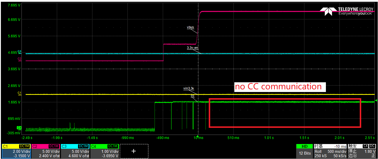

Test 2: disable the external LDO, the 3.3V/1.8V will power from internal LDO, in that case, when negotiated to 15V, the found that the CC line have no any communication, it's that normal? pls check the waveform below.

test 1 waveform:
Test 2 waveform:
    For the CC communication, it depends on the messages being sent between test 1 and test 2. You would need to use a PD analyzer such as the Total Phase PD analyzer to read the messages being sent back and forth and if it makes sense that the PD controller is not responding.

    Question 2 and 3: Test 1 and Test 2 CC communication
    • I need the actual PD logs to determine what the communication is during this time. Cannot tell the difference in CC communication looking only at the voltage toggling
