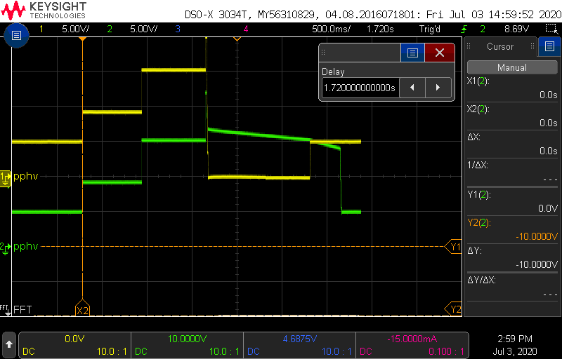

I connected the USB-C-PD-DUO source to the sink. I was able to change the VBUS from 5V to 9V and 15V, however when I attempted 20V following the instructions according to the EVM user guide, I was unable to get a 20V VBUS. Both of the boards were tested from out the box configuration and were reflashed once. In both cases, I was unable to get the 20V VBUS and the 5V LED lit up.Based off the scope, when the 20V is pressed the VBUS voltage goes up to 18V for a second then drops to 5V. What I do to make it hold a 20V VBUS. I have included the set-up and state of the EVM when the 20V was pressed.

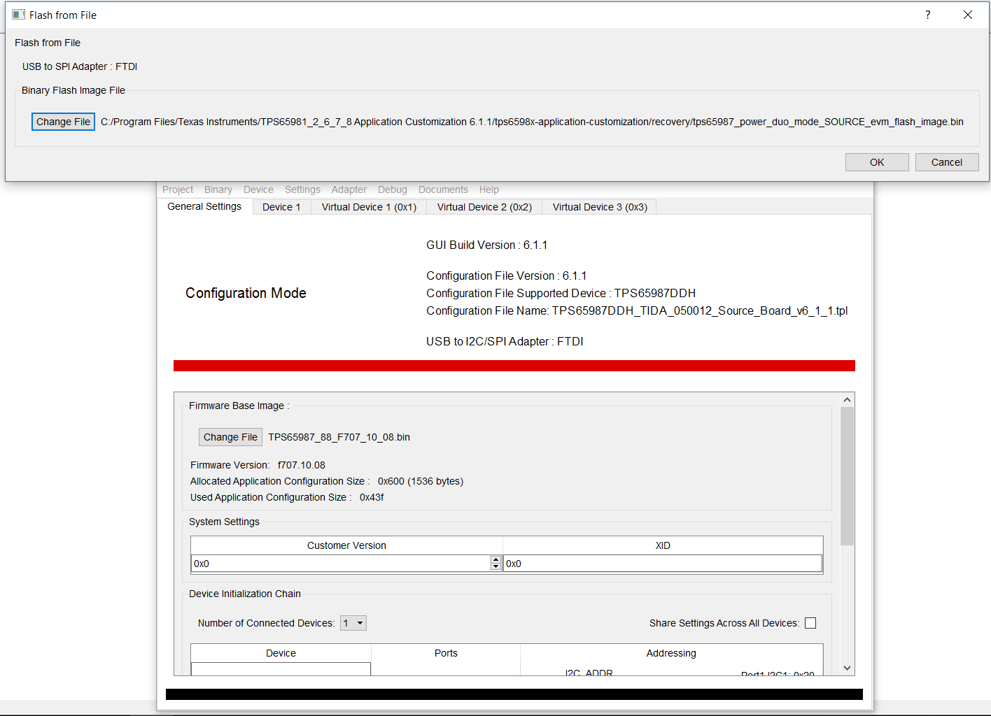

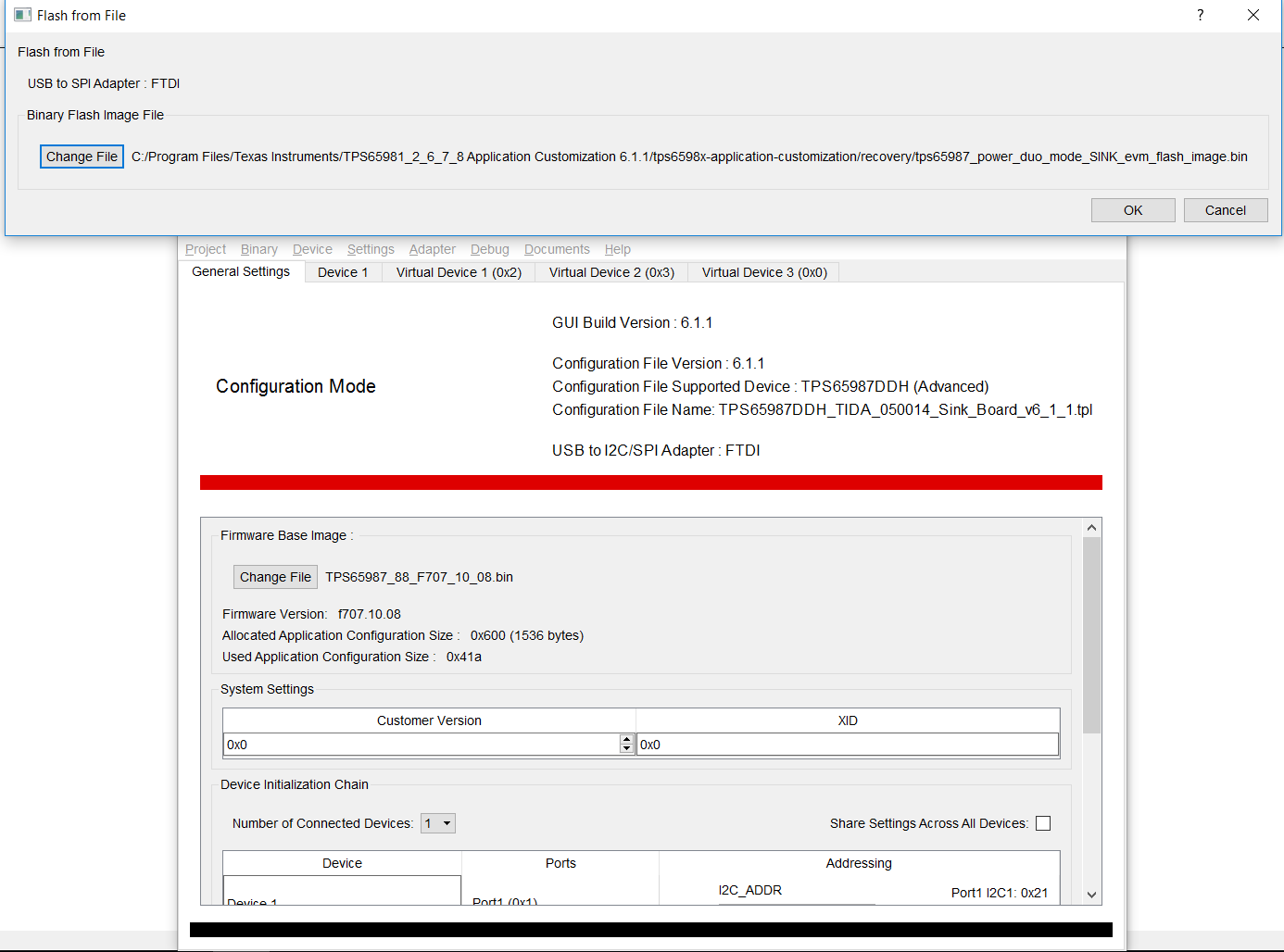

    When you were flashing the boards, did you program both boards, first the source board with J202 in SRC with the source.bin file and then changing the J202 jumper settings to SNK mode and then programming the sink board with the sink.bin file?
    Also, which GUI version are you using and could you attach your project file that you flashed on the board to this thread?

    Yes I programmed the EVM following the order indicated on the EVM manual. I checked the that the file was correct for both source and sink and programmed the source board first with the jumper moved to SRC and subsequently changed back to SNK when programming the sink.
    Have included the project file below:

    Just to double check, how are you flashing your board, using a Micro USB cable or a debugger? Also, are you also power cycling/resetting the source board by unplugging the barrel jack after flashing it first and then plugging it back in to flash the sink board?

    I am flashing the board using a micro usb cable. Yes indeed I power cycled the boards when I flashed them. The issue of the 20V not syncing actually occured before I flashed the EVMs. Hence, I flashed them after, and the issue persisted.

    I was able to try this on a new out of the box power duo board and initially the sink board won't be able to go directly to 20V from boot up, so I have to press the 20V button on the source board to enable that PDO and then once I press the 20V button on the sink board, it negotiated that higher 20V contract. Would you be able to double check that as well with this process while you upload your pictures/video?

  • Hi Hari,
    Just to add on, this is the scope image when the 20V contract is pushed. The yellow line is the source and the green is the sink.

  • Hi Zhen,
    Yes I recommend always using an E-Marked cable as it is certified by the USB-IF to ensure proper functionality.
