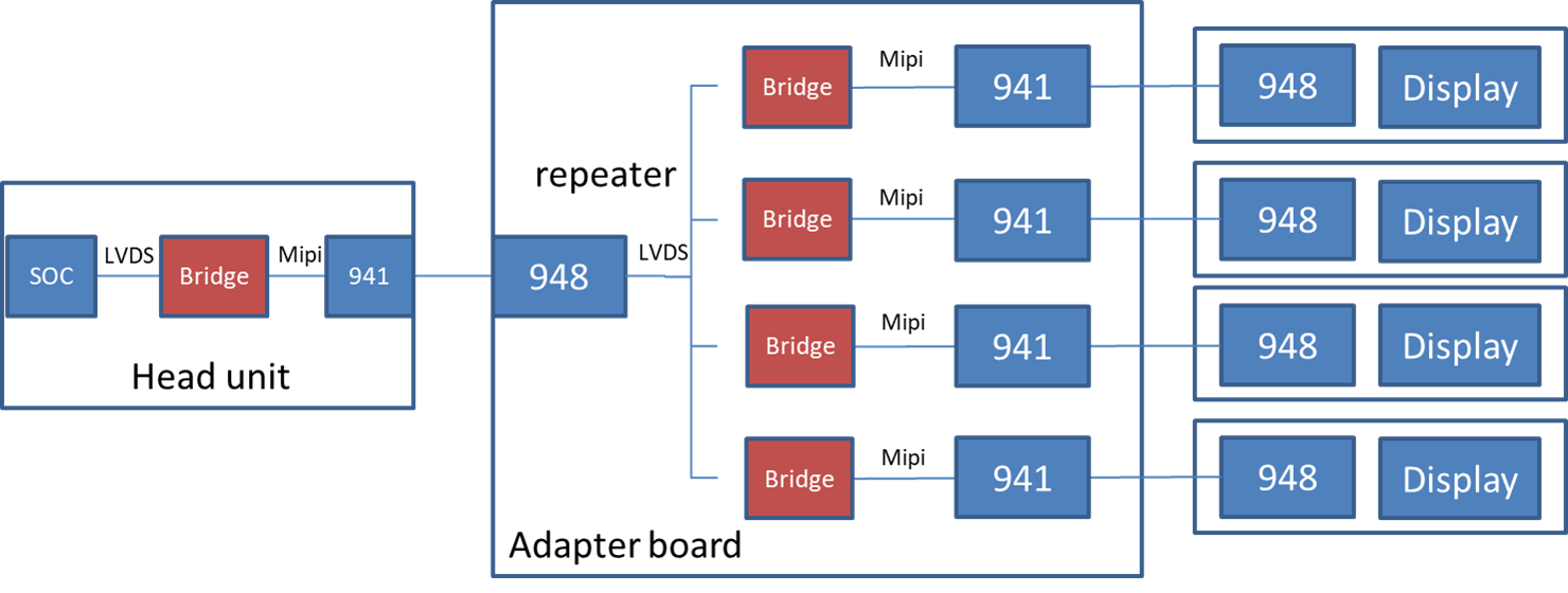

Just want to confirm that whether 948 could support 3840*720 @50 fps.
PCLK=.3840*720*50*1.05=145MHz<170MHz.

yes, it can. for your video format, the PCLK is ~150MHz, and our 948 can support up to 192MHz PCLK.

Hi Steven,
Thanks for your quick response. I am confirmed with customer that they still need 60 fps, which means PCLK need to support 3840*720*60*1.05=174MHz.
So they can't use 947 (only 170MHz) +948. They need to use 941 and 948. But their SOC output only support LVDS.
So we need LVDS to Mipi bridge. As for Mipi to LVDS, we have DSI 83/84. But as for LVDS to MIPI (PCLK could support 174MHz), do we have such a bridge?
as i know, we have no dsi2oldi device, you can check the FPGA solution for this.
but i think it is better if you can reduce the frame rate you can use 947 option.
