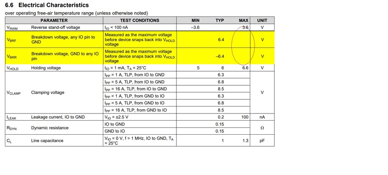

Part Number: TPD1E1B04
Hi Sir,
may i know breakdown voltage maximum value of TPD1E1B04 , if can't provide, please kindly tell me reason. thanks for your help.

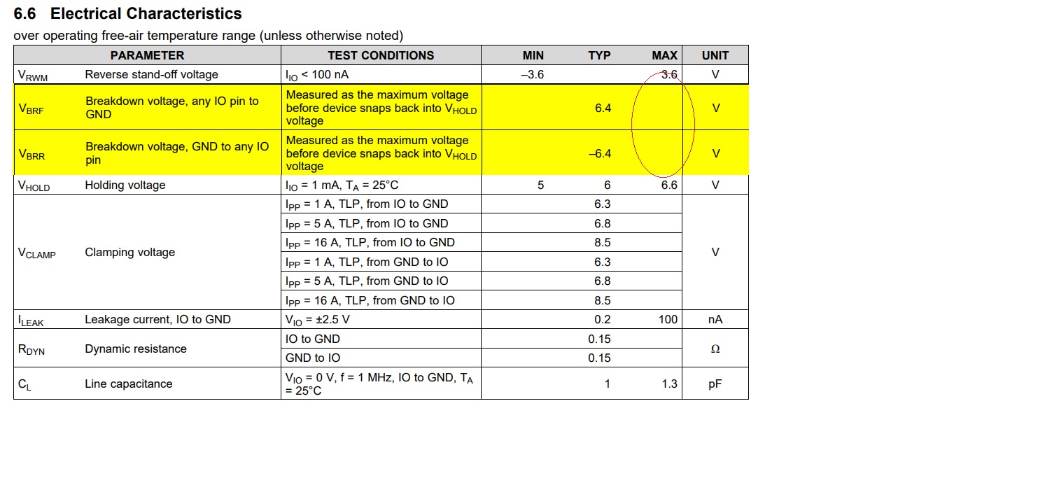

Hi Sir,
Hi Tommy,
Welcome to E2E!
From data I was able to find the maximum breakdown voltage observed was 7.1V. As this is data not included in the datasheet this information should be used for design reference only and is not guaranteed by TI.
