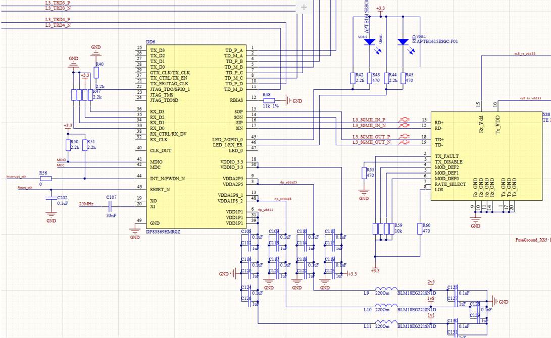

Hello.
We have an issue with DP83869HM and need a support.
DP83869HM is connected to KSZ9477 by 1000Base-T with blocking capacitors.
After device is powered up, the link between DP83869HM and KSZ9477 is established.
We want DP83869HM  to work in 1000 media converter  mode.
According to datasheet:
 “NOTE: Important: Required register configuration for 1000 Mbps Media Converter mode: - Write
0x1FFC to register 0x01EC (set bit [0] to 0)”
The link between ICs is getting lost in 10 seconds after 0x1FFC value is written into register 0x01EC.
Writing back the value 0x1FFD  into register 0x01EC does not lead to link recovery.
Link can be established again only after hardware reset of both ICs.
1000Base-X mode also does not work. It seems, device can transmit, but can't receive.
 Reading SERDES_SYNC_STS Register (Address = 0x4F) gives 0x0270:
Synchronization Status  0x0 = No Sync
SFP-module we are using - NM3112-02-i - is OK. By connecting this module to KSZ9477 switch, we can get a stable 1G link.
But 1000Base-T link between KSZ9477 and DP83869HM is lost immiediately.
Link can be restored by power cycling.
The distance between DP83869HM and sfp-module  is less than 1 cm.

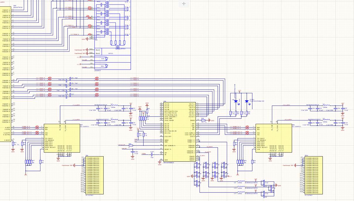

Schematics are attached.
What could you recommend to fix this problem?
  • Hi Slava,
    Please help me out by clarifying the following :
    1. Without writing to register 0x01EC, does link stay stable?
    2. When link is lost after writting register 0x01EC, does link recovery happens by only reseting 869 or only resetting KSZ?
    3. Does this SFP module has inbuilt dc-block caps on the sop, son, sip and sin lines?
    4. Did you also try disabling Sgmii auto-neg with register configuraiton of register<0x14>?
    Vikram

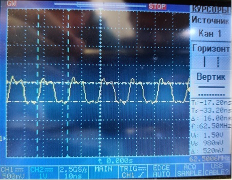

    3.   The recommended circuit from the SFP module datasheet: In addition, I tried external capacitors on the SIP/SIN line of dp83869. Also I tried a 100 Ohm resistor near dp83869 between SIP and SIN.
     The waveform above is taken from the outputs 12 and 13 of the SFP module (or the inputs 16 and 17 of the dp83869) relative to the ground. The waveform is the same for both inputs 16 and 17. An external 100 Ohm resistor was used between SIP and SIN near dp83869, although it was not necessary. The mode is 100base-fx.
    4.    I tried to write different values of 0x2947/2907/2807/2827 to the register 0x14. The register 0x4F has a stable value of 0x0200 (no sync), and 0x0c01 has a stable value of 0x6149.
    I am checking with team here and hopefully get back to you in two days. I am summarizing my understanding here. Let me know if I got something wrong :
    1. Copper side issue :
    a. Link is stable before writting reg<0x01EC> = 0x1FFC. Looses link after 10s of writting this value for both 100BTx and 1000BTx link case.
    b. Only writting reg<0x001F>=8000 recovers the link and keep it stable. (this is the hard reset and actually resets the value of reg<0x01EC> to default and hence is linked to observation a)
    2. Fiber side issue :
    a. No link ever even with different configurations of reg<14>
    b. 100 ohms termination should not be placed as 869 has inbuilt termination .
    c. SFP already has ac coupling caps -> so extra ac coupling caps are not required.
    d. 62.5MHz periodic signal is observed on SFP's outputs. (This does not look like a correct signal type but I am checking again with team).
    Vikram

    Thanks for sharing the register values. Here is the summary of my discussion with team related to this issue :
    a. Dont update register 0x01EC
    b. Team is looking into possible error in description in datasheet.
    a. We have not seen this "never linking up" issue on fiber side and we need to look at the way to make it work with selected SFP.
    b. Observed periodic signal of 62.5MHz is not expected either in 100BFx or 1000BFx. Both of them should be transmitting random data pattern of 125MHz and 1250MHz rate. May be the observation is limited by oscilloscope capture bandwidth and you will need higher Gbps scope.
    b. Can we try toggling tx_disable pin of the SFP module + normal configuration to see if the fiber links up?
    c. Can we try toggling tx_disable pin of the SFP module + fiber forced configuration to see if the fiber links up?
    Vikram
