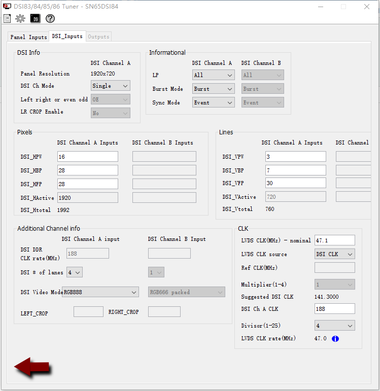

My customer is using a display board which has MIPI DSI to LVDS bridge (SN65DSI84) to give LVDS display. They need to bring up a dual channel LVDS display (COG-CHSDT002-01).
We have configured panel inputs as shown below and DSI inputs according to the datasheet to generate the CSR values. But the display is not working.
The DSI tuner configurations as the below for your reference.
Could you help to check the configurations? Thank you.
In addition, customer feedback that the DSI input is configured as below, and it works, but it is very confused for me.
