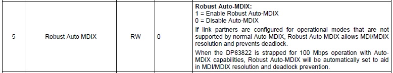

  • Hello Hisao,
    Since you have disabled Auto-Negotiation, you will need to enable Robust Auto MDIX in order to ensure the Auto-MDIX resolves properly in all situations. You can enable Robust Auto MDIX through register 0x0009[5]=1.
    Justin

    The datasheet says that "Robust Auto-MDIX" is used when the link partner does not support the "normal" Auto-MDIX. Could you please explain what is the case to use it? What is the device not supporting "normal"? By setting this bit, are there any affects to other functions?

    "Normal" Auto-MDIX is meant to work in conjunction with auto-negotiation. When auto-negotiation is disabled but auto-MDIX is desired, the IEEE spec is not specifically defined so "normal" Auto-MDIX is not always sufficient. We have included Robust Auto-MDIX for this scenario, which will not affect other functions of the PHY.
