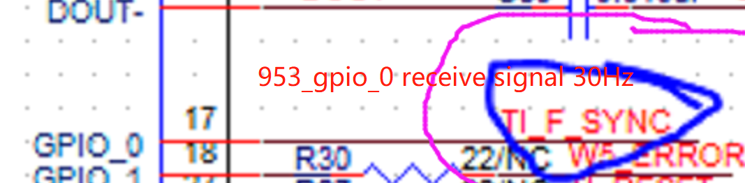

We plan to debug the  external framesync sensor which used the 953 Serializer.
the serializer 953 hardware design  as below:
TI_F_SYNC  source is coming from DS90UB960.

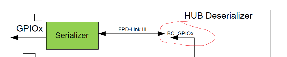

    In Internal FrameSync mode, an internally generated FrameSync signal is sent to one or more of the attached
    FPD3 Serializers through a GPIO signal in the back channel.
    It shows the signal send from Back channel.

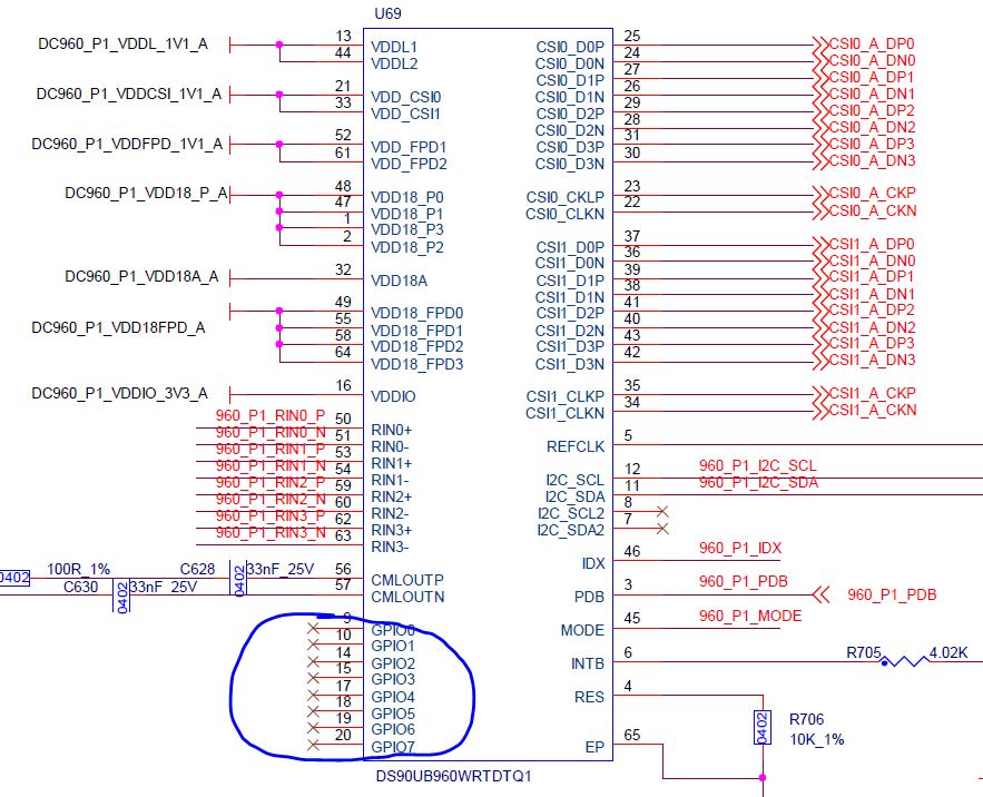

    1)  The GPIOx of HUB Deserializer ,it  means  gpio[0-7] of chip 960 ?   for now,we did not use it.
    in the up picture,the gpio0-7 did not connect anything.
    2)  the up picture,the 960 only connect a clock source of 2 (a 25Mhz clock).If I use Internal FrameSync,Is it OK to configure internal trigger related registers   without any hardware changes ? I am not sure if it needs anyone of the gpio0-7.

  • Hello Yingjin,
    when using the Internally generated Frame Sync you do not need to use any GPIO on the 960. Also there is no hardware change is required.
    All you need to do, is to configure the correct BC GPIO to send FrameSync to the correct RX Port you want, in reg 0x6E and/or 0x6F.
    For more details please check the 960 d/s section "7.4.24.2 Internally Generated FrameSync" . There you have also a code example showing how you can set this up.

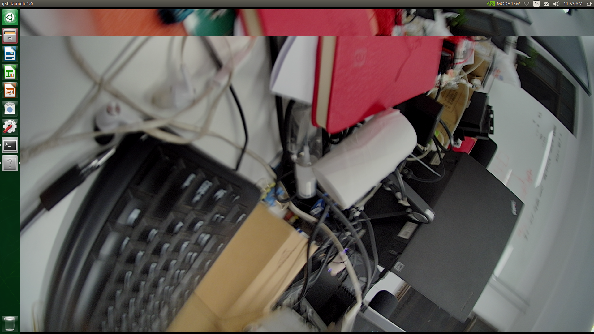

    But the picture has some problem.
    When we use internal framesync of sensor,the picture is right.
    When use the framesync signal,no matter,internal framesync or external signal.The picture is not right.

    I do not know how it is possible for you to use an External Frame Sync signal since all of your Deserializer GPIOs are NC.

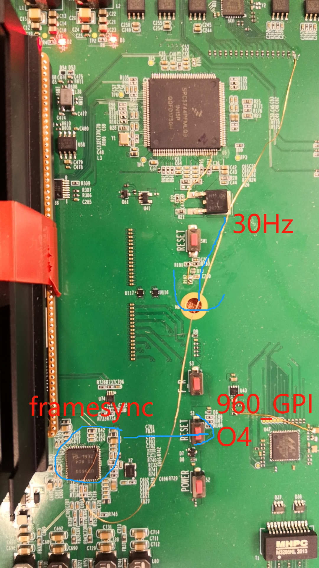

         The original design of the board didn't connect to GPIO, and then we welded the wire to 960 gpio4, it as below:

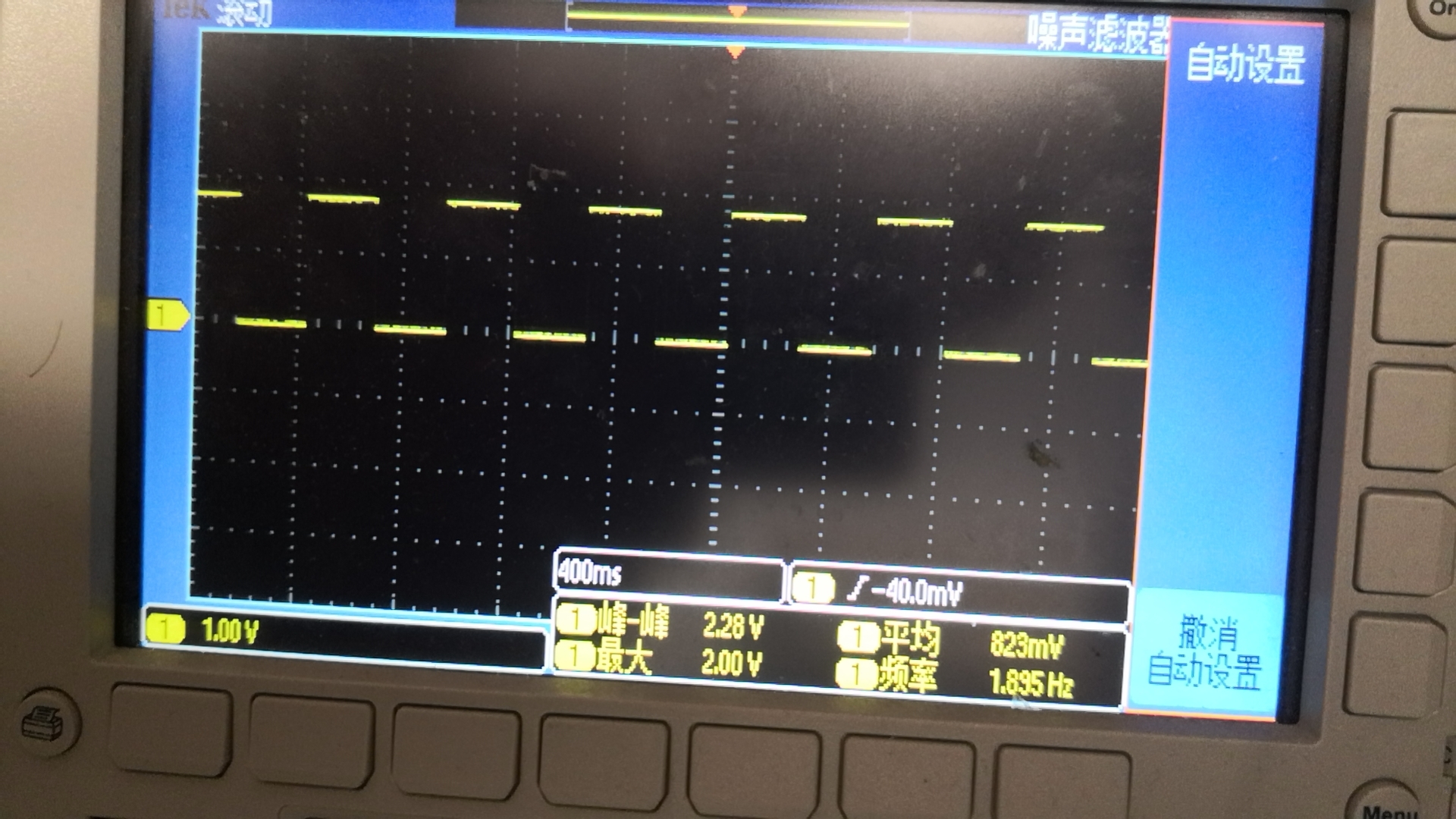

    we can measure a 30Hz clock in the ser gpio0 of 953,it as below:
    scope as below:

    2 )  At this time your picture starts flickering on the display, is that truth?
          Yes, it starts flickering on the display,I did not know why.

    3 ) Can you confirm that your Sensor is running at 30FPS ?
          I can measure the clock output from  953'gpio0  is 30 Hz,but how to check it works at 30fps.
          We have confirmed with the camera sensor supplier that every time a trigger signal comes, the sensor will output a frame of image data. If the trigger signal is always at a high level, the firmware of the sensor will fix a 30 frame image data.

  • Hello Yingjin,
    As I said, it looks like the sensor is not running exactly at 30FPS but you are sending a 30Hz Sync signal which makes the Sensor out of Sunc.
    So you need to check the settings of the sensor. The problem has nothing to do with the SER or DES.
