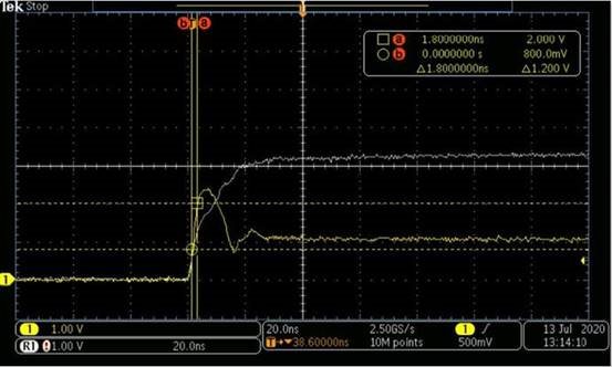

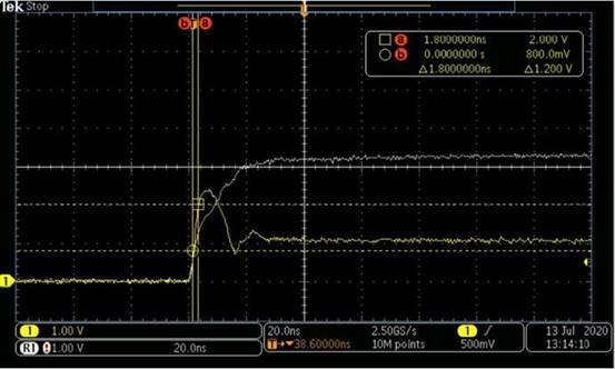

We set the GPIO3/INTB being the input port and CPU will provide the high and low signal to GPIO3/INTB. In CPU side, we could select the drive current to be 2mA/4mA/8mA.
As you see in below waveform, white is successful low to high transition and yellow is failed low to high transition. If we set drive current = 2mA, the low to high transition is seldom failed. If we select larger drive current, the failed rate will become bigger.
We also change to use GPIO0/1/2/4/5/6, they are fine to use higher drive current. So we think the root cause is the multi-function of GPIO3.
Could you let me know the limitation of using GPIO3 like low to high slew rate or ......? Also let me know why higher drive current fail the transition.

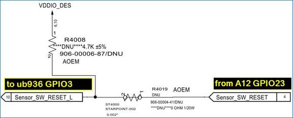

    I modify my question and short my question. Now my condition is that I don't use the external pull up circuit. Just connect GPIO3 to CPU GPIO pin.
    And my issue is that when CPU GPIO pin send the high signal.(original status is low)
    The GPIO3 pin will sometimes clamp on 1.3V. If we adjust the drive current(higher), the issue could be occurred frequently.

  • Hi Casey,
    As you see, this is our original schematic. And there is sometimes transition(low to high) fail in GPIO3(input type). (clamp on 1.3V)
    We find the reason is sensor_SW_RESET drive current. When we boost the drive current to let GPIO3 from low to high which means the low to high slew rate is more quick. The GPIO3 voltage will clamp on 1.3V.
    If there is anything unclearly, you could refer to e-mail attachment that I sent you. I think customer description is detail.
    I just would like to say the issue is not related whether we place a pull high resistor to VDDIO. It's related the low to high slew rate may cause the transition clamp in 1.3V. And only occur in GPIO3.

  • Hello Roy,
    Again, there should be 0 drive current coming from the MCU to set the logic high state because the MCU output should be set to open drain I/O, not push pull.
