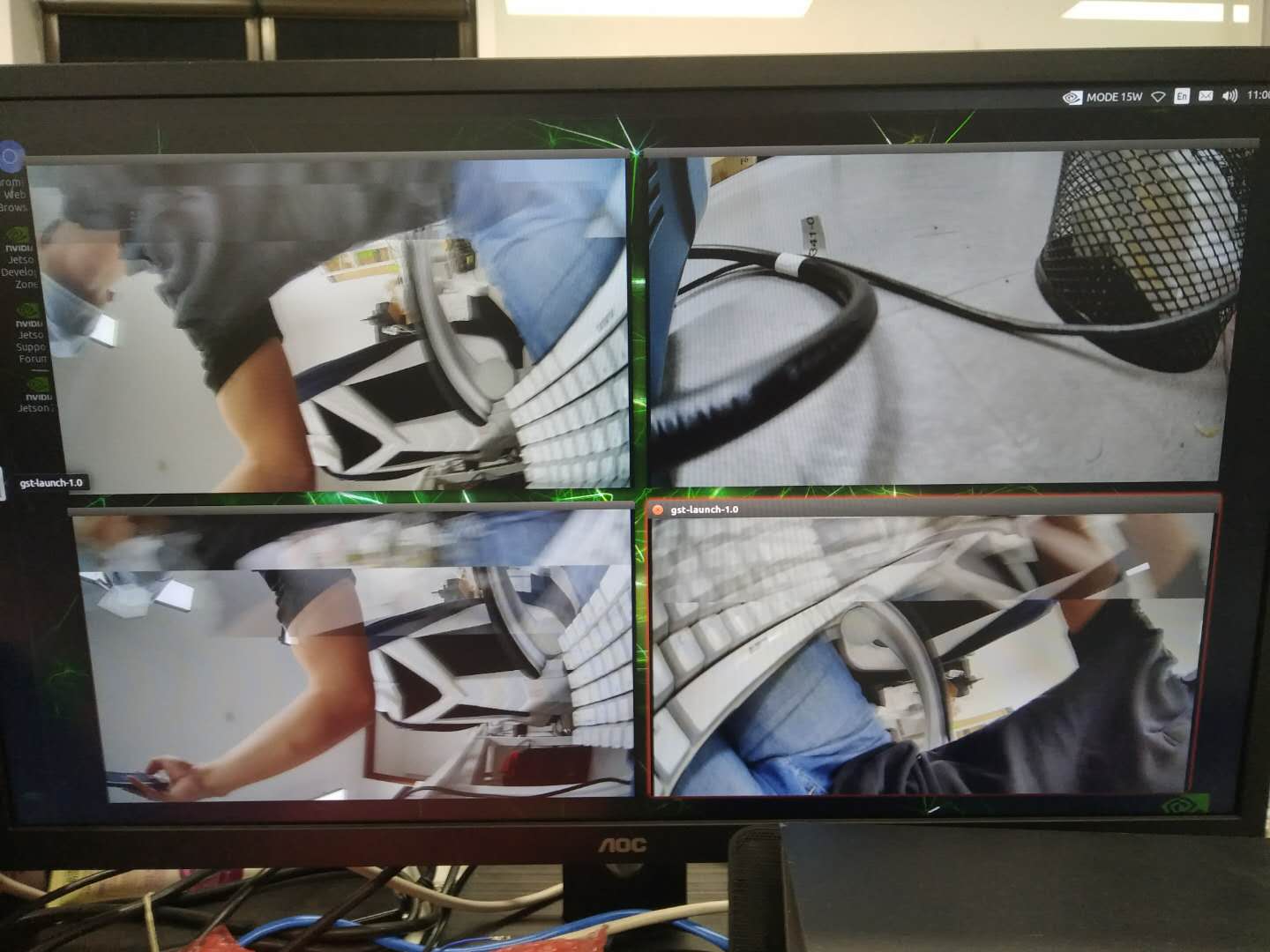

This is the question I submitted before. I used the internal trigger sensor. The problem has been solved, and 4 cameras can be turned on at the same time, and preview normally.
Now I have replaced it with the external trigger camera.  I use the internally generated framesync mode to provide framesync signals to the sensors,The following is the configuration of the register. And the display effect is shown in the picture.
There are three camera images that can be previewed in real time, but the images are misplaced, as shown in the picture. The other one camera only shows one image and cannot be previewed in real time
Is this a problem with sensor or 960 or 953 configuration?
Looking forward to your reply, Thanks very much.

  • Does anyone have a similar problem? How to solve the problem ?
  • Hi Xiangbo,
    Looking at your script, you need to have GPIO0 disabled as an output, and instead have it enabled as an input. You can send you external frame sync to GPIO0.
    Then you need to change 0x18 [7:4] = 1000 and [0] = 0 to turn on FS generation and enable FS from external GPIO0.

  • hi Sally,
    The current configuration is using internal frame sync. Because of the hardware design, it is impossible to input square wave signal to 960 gpio0. I want to know if there are still problems in my configuration and why the 4-channel video can not be displayed normally
    thanks very much.
  • Hi Xiangbo,
    For internal frame sync please see my attachment script. I have made some changes and added comments to your script.

  • Hi Sally.
    We tried the External FrameSync Control by taking 960 gpio4 out by welding wires, and sending in a square waveform.the frequency of the square waveform is 30Hz, and the duty cycle is 50%. The external signal can be transfor to 953 and been output through the GPIO0 of 953. On the pin of 953 GPIO0,The signal can be measured through an oscilloscope.We can get video stream by gst command, But the stream is also abnormal, As show in the video. I turn round the camera body's angle, 0, 90, 270, 360 degree,No matter which angle, the top of the screen is always abnormal. I only connected one camera, Before I still think this is  a proble of bandwidth, while I change the square waveform frequency to 1.8Hz, the problem is alse exist. Now i think this is not a problem of bandwidth, And I had configure the CSI-2 Output Lane Speed to 1.6Gbps.What's the problem?
  • Hi Xiangbo,
    In this video, you only have on camera connected? In your previous photo, you did not show this issue. Have you changed any other configurations besides external frame sync?
    Sally
  • Could you try running the script I sent you before? I just want to make sure we can work through this together, step by step. Let's get all the cameras running with internal frame sync and make sure there is no issue. Then I can send you a new script to transition to external frame sync.
  • Hi Sally
    I only connect one camera on my board.
    In previous i didn't describe the problem clearly. In my previous photo, The phenomenon of the problem is the same.And there was no video file provided previously, so it's not easy to Distinguish it.
    This problem occurred after the external trigger camera was replaced.I thought it was also caused by the bandwidth problem, but now I find that this problem also exists when only one camera is connected.
     I tried External FrameSync Control and Internally Generated FrameSync, But now whether Internally Generated FrameSync or External FrameSync Control the problem is exist.
    In Internally Generated FrameSync mode, Whether your script or mine the problem is remained, The GPIO0 of 953 is constant value of 1 which I throuth should be a square waveform.
    Thanks.
