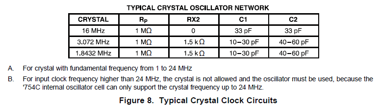

I found recommended external Xtal value in the datasheet.
However, I would like to know recommended Xtal vendor.
Could you please let us know if you have any information?

    We do not recommend any specific crystal vendor for this device.  The recommended R/C values above are a suggestion based on typical crystal characteristics, but could be modified slightly as needed to support a given crystal device.  Generally it is likely best to pick a crystal which could support similar load capacitances to what is shown in this figure, though, since the crystal driver circuit is known to work well with this recommended loading.
