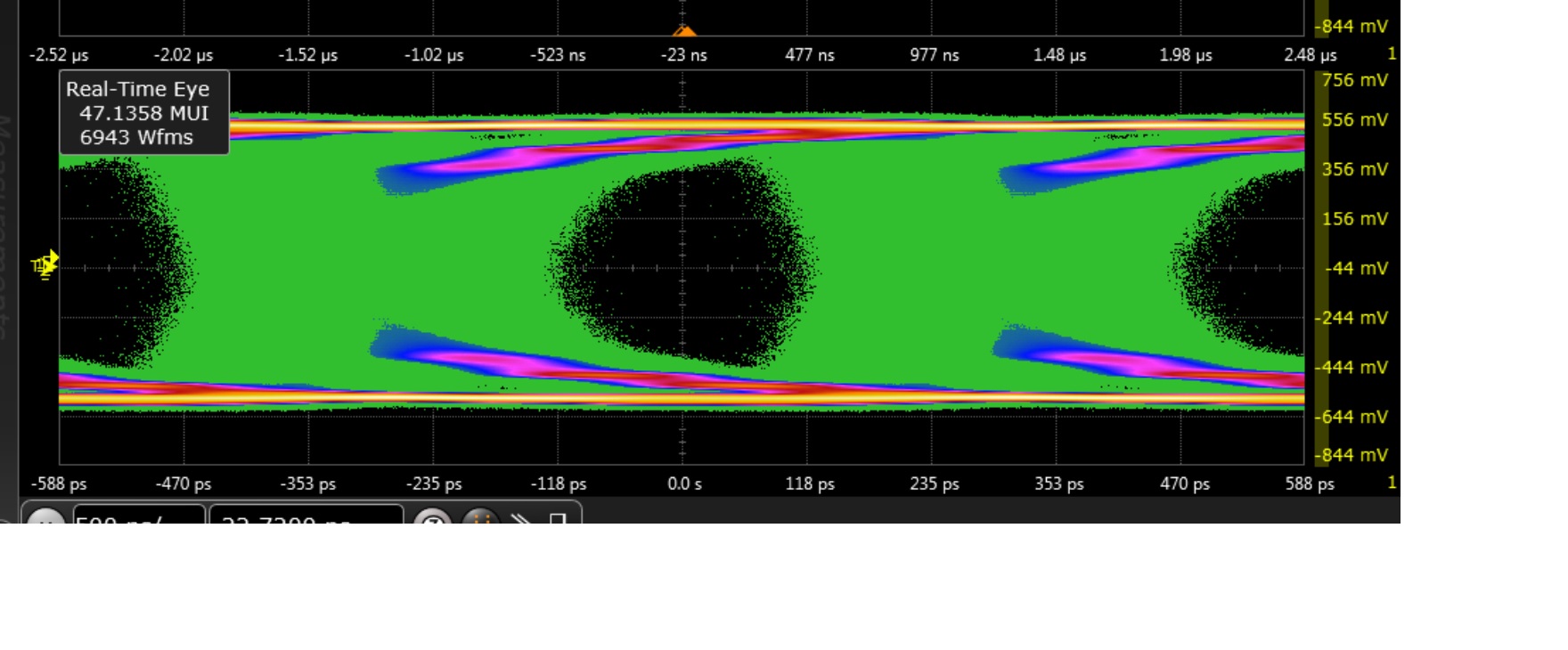

hi
Eye diagram is shown in the photo does not look very good, is there any suggestions?
Eye height below 600mv is the normal range, right? (Based on 100ohm)

Hi Ben,
What type and length of cable are you using? How are you measuring the eye? Are you seeing lock issues? I suggest looking at the eye diagram from the CMLOUT pins.
I would suggest leaving R78 and C84 DPN and changing R78 to 49.9ohm.

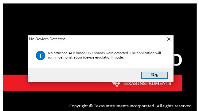

The Analog LaunchPad is a free software you can download here: https://www.ti.com/tool/ALP

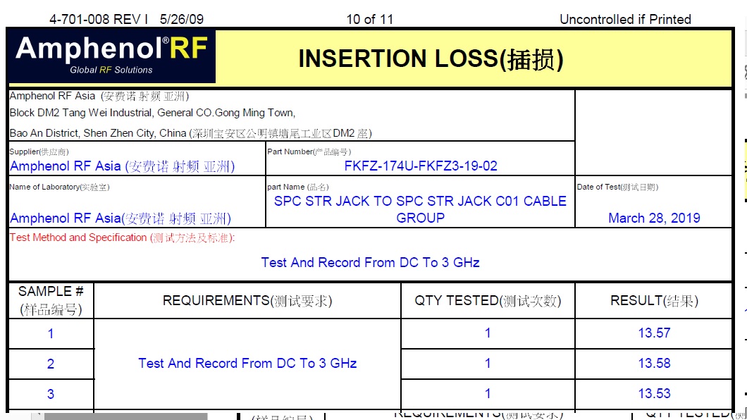

Could you also clarify your issues? Are you seeing lock instability? What type of 15m cable are you using? Do you have the insertion / return loss data of the cable?

Do you have a USB2ANY(https://www.ti.com/tool/USB2ANY) or Aardvark? You can use those to interact with our ALP.
Do you have the insertion loss data for the cable?
Hi Ben,
What does the RESULT mean? -13.57db insertion loss at 3GHz? Is there a plot over frequencies?

hi
Can any USB to I2C solution be used? Or are they bound to specific chips?
Is this ok?
Hello Ben,
Only USB2ANY or Aardvark have been qualified for running the GUI
