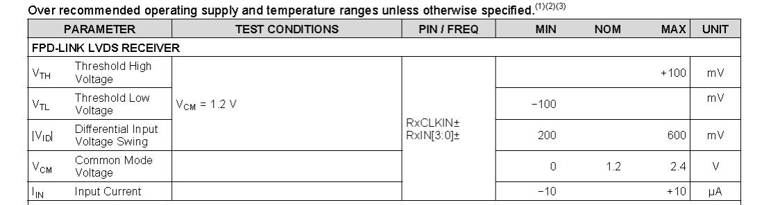

    My customer also feel confused about the VCM. Why the max value of VCM is 2.4V? In which application, will VCM become 2.4V?
  • Hi Amelie,
    It will remain nominally at 1.2 V.  This is the LVDS interface and not the LVCMOS I/O.

  • Hi Bryan,
    If the LVDS output signal from MPU to 927 is VCM=1.2V, and 927's VDDIO=1.8V. I could know that no problem.
    But if the LVDS output signal from MPU to 927 is VCM=1.2V, but 927's VDDIO=3.3V.
    What is the actual VCM voltage on the LVDS from MPU to 927?
    Is it still 1.2V?
    Or because VDDIO of 927 is 3.3V, so VCM from 927 is higher than 1.2V. Will it make the LVDS signal come back from 927(VCM >1.2V) to MPU(VCM=1.2V)?
    Or actually VDDIO only decide the GPIO voltage(such as I2C/I2S), not decide the LVDS VCM?
  • Amelie,
    Bryan has already explained several times. VCM for the LVDS interface is independent of VDDIO. No matter what configuration the device is used in, the VCM will be typically 1.2V but could range from 0-2.4V.
    VDDIO controls the other I/O voltages like GPIO, I2C, I2S as you say
