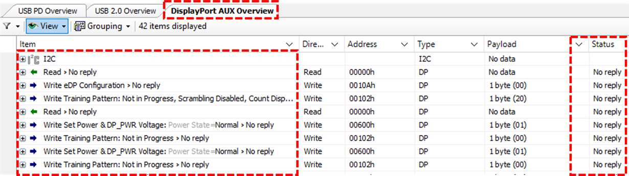

We are using the SN65DSI86 MIPI DSI to DisplayPort bridge for a custom implementation that follows the design shown below.
(Processor) -> (SN65DSI86) -> (USB-C connector) -> (USB-C to HDMI convertor) -> (monitor)
(Processor) -> (SN65DSI86) -> (USB-C connector) -> (USB-C to DisplayPort convertor) -> (monitor)
On our PCB the TEST2 pin of the SN65DSI86 is pulled high, and a Linux driver configures the bridge disabling the ASSR feature, there have been performed different tests using the following USB-C convertors:
(a) https://www.amazon.com/Digital-Multiport-Adapter-Nintendo-Portable/dp/B07JK9DFKH
(b) https://www.amazon.com/Belkin-Thunderbolt-Transfer-Upstream-Charging/dp/B07YLMJZXB
(c) https://www.tripplite.com/usb-c-docking-station-4k-hdmi-thunderbolt-3-pd-microsd~U442DOCK10S
The only device that works correctly is (a) which completes the Link Training and displays image on several HDMI monitors.
When using the other two USB-C adapters (b and c) we have noticed AUX communication issues, using a USB-C Type C analyzer it can be seen those transactions are not acknowledged.
Is the bridge compatible with those USB-C convertors?
Which USB-C convertors can be used for this implementation?
Any information that you could provide us would be helpful.
