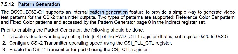

Right now, we are testing the Patteren Generation function on DS90UB962 and DS90UB936, like below picture describe.
I use i2cset tool to configure them.
i2cset -f -y 3 0x34 0x20 0x30
i2cset -f -y 3 0x34 0x1F 0x02
i2cset -f -y 3 0x34 0x33 0x01
But after I configure those register,
there is nothing output form DS90UB962-Q1 CSI0_CLKN and CSI0_D0N, those PINs  are still at low level.
And in DS90UB936 part, I can see the CSI pins be pulled high to 1.8v level, but there is still no data and clock output.

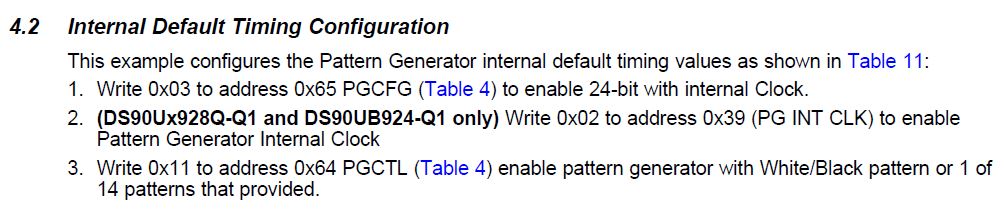

I also try the steps of Internal Default Timing Configuration on snal132e.pdf
Also use i2cset tool,
i2cset -f -y 3 0x34 0x65 0x03
i2cset -f -y 3 0x34 0x64 0x11
But there is still no output on DS90UB962 CSI pins.
Actually I compare the two registers in DS90UB962 and DS90UB936 datasheet,
0x64 and 0x65 should be Slave register,
So I am not sure I should to follow which one pdf file.

    The pattern generation manual you are using was written for IVI devices, whereas the 962 and 936 are both ADAS devices. The datasheet for these devices contains the right register information, so disregard the programming of Internal Default Timing in registers 0x65 and 0x64. Those are slave registers on the 962.
    Make sure that your tx speed and lane count are configured correctly for your receiver.
    Pattern generation features on the ADAS and IVI devices are different, so be sure to follow the 962 and 936 datasheets carefully and program the correct registers. Please reference 962 datasheet section 7.5.12.4 and 936 datasheet section 7.5.11.4 for information on programming the indirect access pattern generator registers.

    In 936 part, I follow 7.5.11.4 to setup register config, now I can measure some data form CSI pins.
    But in 962 part, I follow 7.5.12.4 to setup, I still can't mesure anything.
    And then I double check 0x33 register in 962.
    I find 0x33 register in 962 can't be changed.
    after I set 0x01 to 0x33 register in 962, but It is still 0x00 value.

    On the 962, register 0x33 CSI_CTL is a TX port specific register. To read and write to CSI TX port specific registers, you first have to configure register 0x32 CSI_PORT_SEL. Set register 0x32 to 0x01, and then write to register 0x33.
    Carrie
  • Hi Carrie:
    Thanks a lot!!!
    After config 0x32 CSI_PORT_SEL register, now we can enable CSI_CTL successfully.
