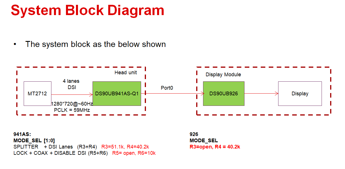

How to configure 941as register when pairing with DS90UB926-Q1?   We have configured 941 the below register, but there is no HS/VS signal, and it has CLK, RGB data and DE signal.  Could you help to check which registers need to configure?   Thank you.
0x01= 0x08;
0x1E=0x01;
0x40=0x04;
0x41= 0x05;
0x42= 0x40;
0x17=0x9e;
0xc6=0x21;
0x01=0x00;

  • Hi Bryan,
    You can refer to the below diagram.  I want to know which registers will affect the HS/VS signal output? Thank you.

  • Hi Bryan,
    Please see the system block diagram.
    Yu
  • Hi Yu,
    Based on the diagram above, the connections should be handled with a single port configuration.
    For Modsel[1:0] instead of splitter mode, strap for normal operation.
    Normal + DSI Lanes
    When strapped in this configuration, the device should lock when powered on.
    Confirm lock.
    After lock has been confirmed, use patgen using internal timing to test timing out on the 926.  Confirm you see the HS/VS/DE/RGB signals.
    Modify timing values as needed with patgen to ensure proper color bars on the display.
    After confirmation of all the above, please let me know and we will move on to bringing up the DSI interface.

  • Hi Bryan,
    For Modsel[1:0] is correct, splitter=0.
    In fact, the lock is normal now. And there are CLK, DATA and DE signals, but there is no HS and VS. What configuration is required for DSI on the 941 side? Thank you.
