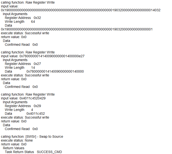

  • I did try that.  I actually just found a more detailed doc here, but still having trouble.
    I wrote this script, but no luck.  Is there a reason the read values are 0 from the first 3 registers?
  • Hi Chris,
    The read should have read the written value. I will need some time to investigate this.
    So, it appears that you want to switch to a source role after you detect and OTC device. The last command you executed (Swap to Source) seems to have returned successfully, but you still see that the device is in a sink role? Can you share the PD logs from a tool such as TotalPhase?

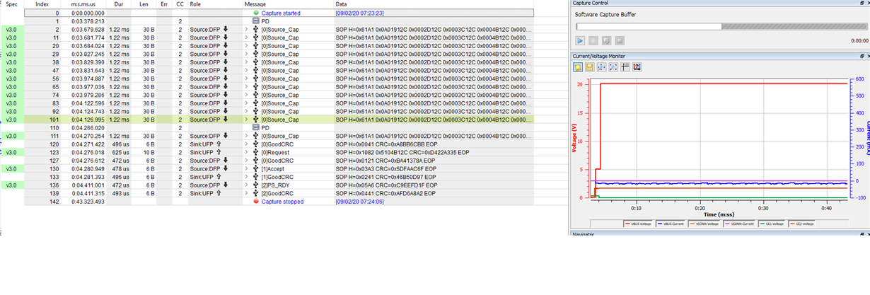

  • At the time the logs I shared were everything I had.  The PD Analyzer wasn't displaying anything because there were no messages being sent.  I've since made some further progress but still have issues.
    The TPS chip won't successfully execute an SRDY command no matter what other commands I give to try and alleviate the problem.
    At the moment I'm only talking to the chip with the App Customization Tool until I can get proper operation.  At that point I'll move the commands to my micro over I2C.
    Anyway, here is the PD state machine trace:

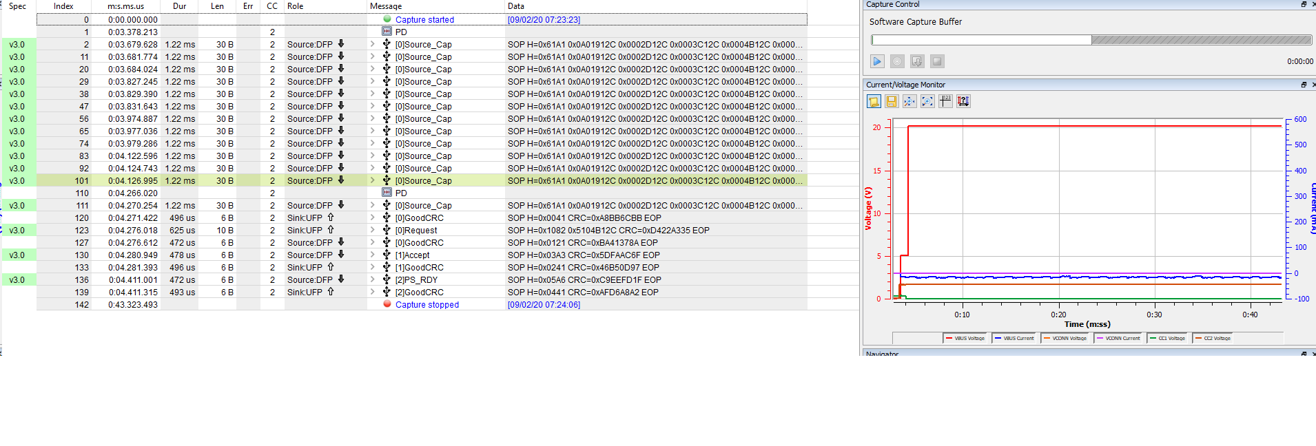

    And here is a screenshoot of the PD analyzer trace:

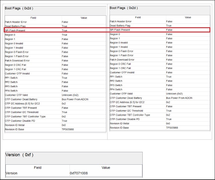

    Can you please share a screenshot of the Boot flags in debug mode?
    This tells whether a flash boot was successful or not. Also, Can you confirm the "Version" register in the debug mode shows the correct patch version?
    Kedar
  • The boot flags seem to be inconsistent.  Sometime they say one thing and other times another.  I adjusted the boot resistors so that they use 0.3 to 0.38 ADCIN1 value, or Dead battery mode BP_ECWait_internal and Device Config Infinite Wait.  Is there a way to confirm those settings were properly loaded?  Do you agree they are the best choice in my application?
  • Hi Chris.
    The below highlighted comparison doesn't look right to me. The filed highlighted should be "true".
    Can you confirm under what circumstances the SPI flash doesn't get detected?
    Kedar
  • There is no screen shot or other file in your previous post.
  • It seems the difference is based on whether the USB-C cable is plugged in or not.  Keep in mind I am powering LDO_3V3 from a separate source so that cable shouldn't be needed.  In fact in many cases I would like the device to act as a USB source and their will not be a USB cable plugged in initially.
    Why does the flash only get loaded when USB-C is plugged in?  How can I power the device and configure it so that startup is always the same?

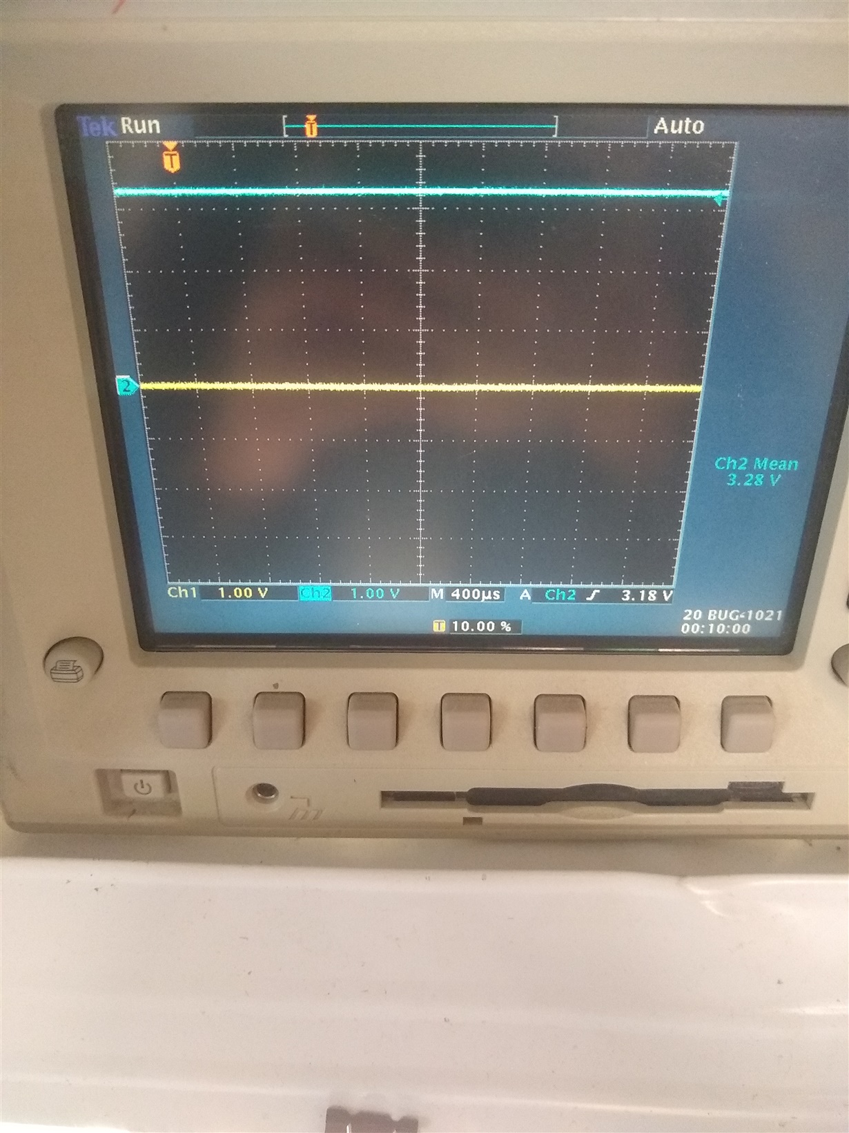

    The power I need for my controller is just a few mA so I think we're good there.  When I measure the voltage I get a consistent 3.27V so I don't think its a question of overloading things.
    I've played with different configurations and whenever the USB is not plugged in it always says SPI Flash Present = False.  What do I need to do to get it to recognize this flash when the USB is NOT plugged in?
    Once I have answered that I can adjust where the power comes from in the different situations.
    C
  • Hi Chris,
    The reason I ask about the voltage is that if it drops at all, the SPI flash would not be recognized by the PD controller. Do you get a constant voltage measurement of 3.3V?
    Also, what exactly are you plugging in, and does the SPI flash regularly show up once it is plugged in and not show up when it is not plugged in?
    Emma
  • I do have a constant voltage measurement on my o-scope.
    I just plug a USB PD charger in.  When I stay the flash is not there I'm referring to the boot flag register.  I have often executed a cold reboot command to see if the status changes but it does not.  I have also removed and reconnected the 3.3V power.
  • Hi Chris,
    Can you attach a picture of the 3.3V measurement from your scope?
    Emma
  • Played around with the system a bit more and found a few interesting things.
    1. SPI flash present is false whenever you re-boot from a cold reboot command.  Not sure why but that significantly confused things.  I have about 3 to 4 cables to unplug to ensure all power to eval board is gone so I thought that was a good testing technique.  No idea why, but apparently needs a real full power cycle re-boot.
    2. I added a small diode from LDO_3V3 to Vin_3V3 and now things appear to work fine.  Dead battery startup is good.  Charging is good.  OTG output is good. If the power is always small (<25mA) do you see any problem with this setup?
