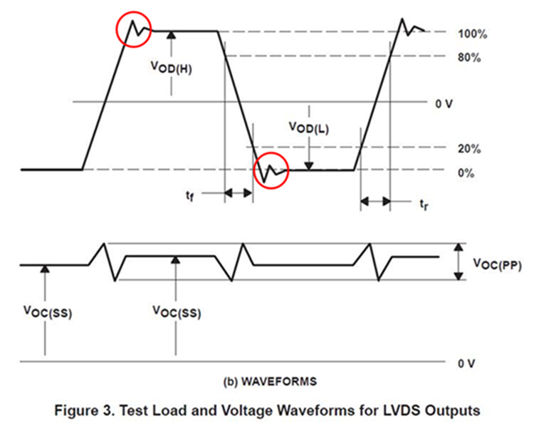

Many datasheet shows that Δ|VOD| "Change in the steady-state differential output voltage magnitude between opposite binary state".
What does it stand for in Figure.3 waveform?
Is it deviation from target amplitude as circled with RED in below?

    Normally, the waveform should be flat if the test condition is good. The figure 3 diagram illustrates the potential noise could be coupling in. We specified the differential output voltage on almost all LVDS products and driven by the Voc. The ripple or overshoot voltage circled in red is normally due to how much you can control and minimize the impedance matching. For example the discontinuity due to the via then it introduce the reflection and appear on the red circle. It can be also coming from parasitic capacitance.

    Could you simply explain definition of ∆|VOD| (Change in the steady-state differential output voltage magnitude between opposite binary states) ?
    Does it mean just difference of amplitude at steady state between H and L(∆|VOD|=|Vod(H)-Vod(L)|)?

    Your thinking is correct.
