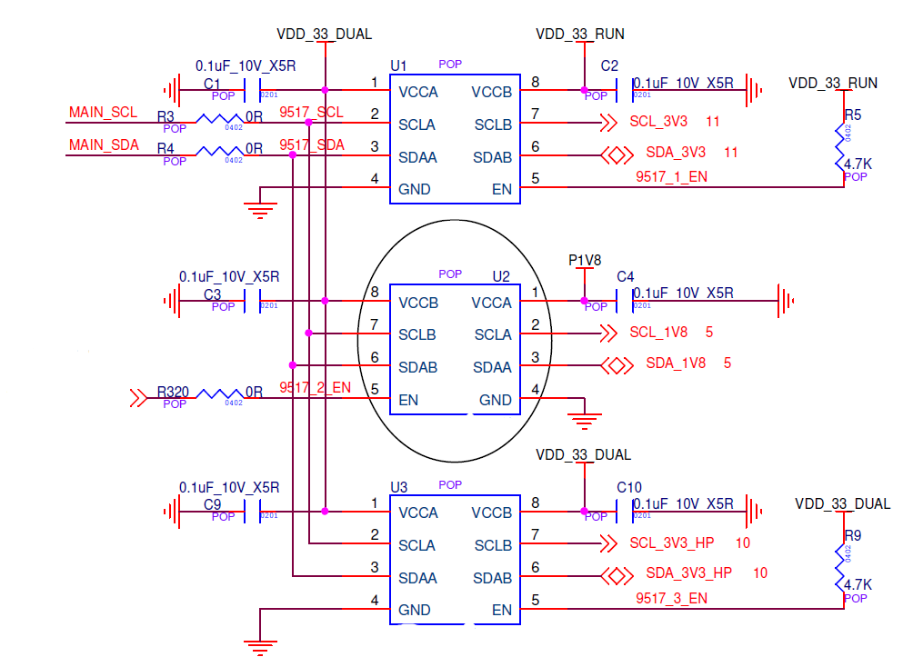

Hi Sir,
Please help to check if the star application is feasible, Thanks.
    • Pinout looks good
    • VccA and VccB have decoupling caps (good)
    • Enable pins appear to be referenced to VccB (good)
    • SDA and SCL net names match pins SDA and SCL (good)
    • No B-sides connected to other B sides (good)
    From everything I can see, this looks correct.
