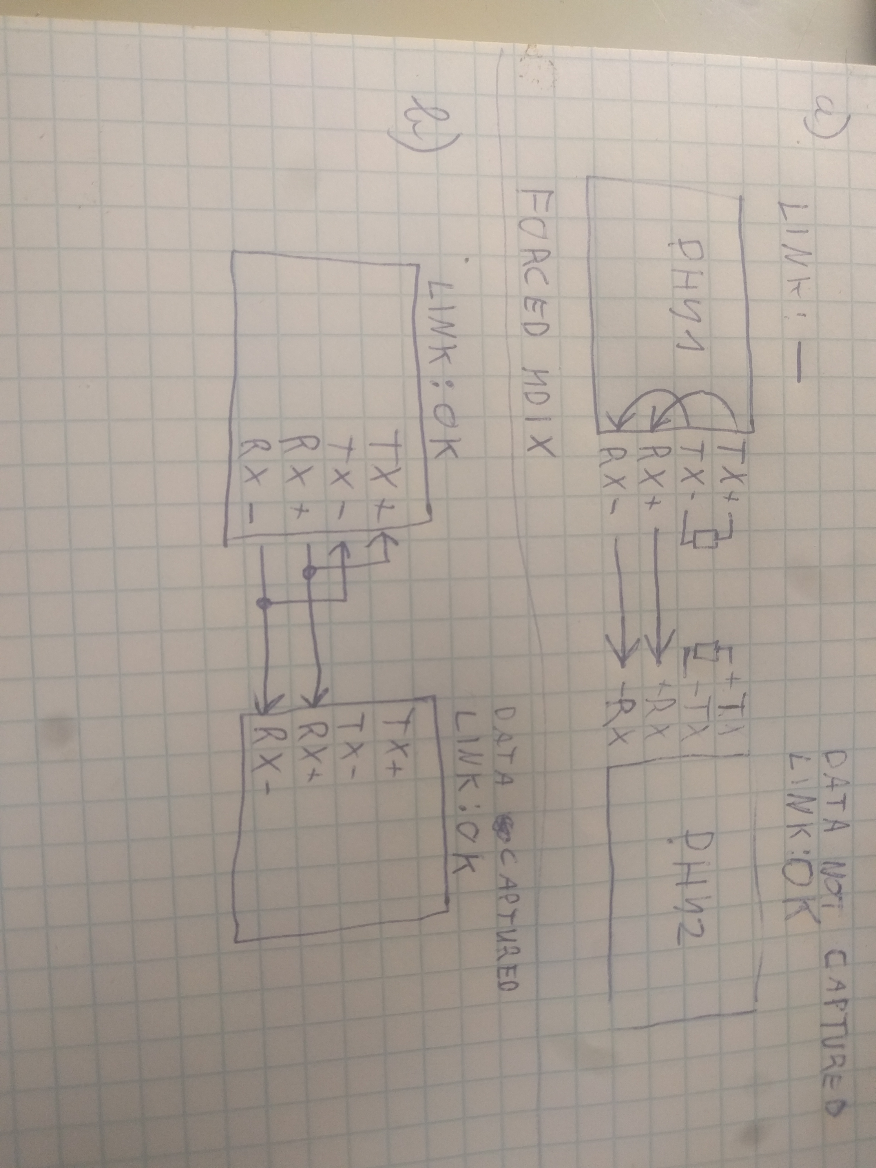

  • Included my register configuration and a schematic about the setup:

    I have shown two test in my included schematic:
    Test a) would be the working solution. Thy physical RX pins connected together and the data direction is controlled by manual mdix on both side. During the test, there was a link on the receiver side, and wasn't on the transmit side. Also, the transmitter didn't transmit any data except idle.
    Test b) On the transmitter side, the RX and TX was shorted together. Thats why the transmitter detected the link and started to transmit valid data.
    So, the link state is a requirement for the transmission. Its specified by the standard and tested on my device as well.
    Can I bypass the link state check in the phy or can I force the link on somehow? What is the requirement for the link to turn on? Its specified by the manufacturer, not the standard.

  • Hi Cecilia!
    >Bit 13 of register 0x40 is a RW. I believe setting to 1 should force the link.
    That was the solution, its working.
    Thank you for the help.
