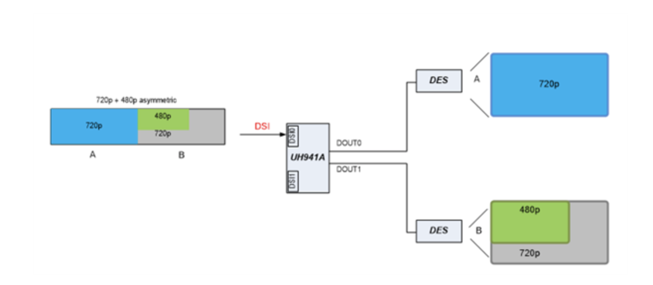

Hi team,
Customer would like to use 941A to design two panel application and below picture is their diagram.
So my question is can 941A support this kind of application?
And I also share their input data throughput quality for your reference. Accordding to resolutions, it seems we should use FPD-LINK4 solution, am I right?
Any suggestion?

  • Hello Paul,
    DS90UB941AS-Q1 supports PCLK up to 210MHz over dual link or 96MHz per single link so that would exclude driving two of any of the panel combinations above. Please send a message internally to discuss roadmap solutions
