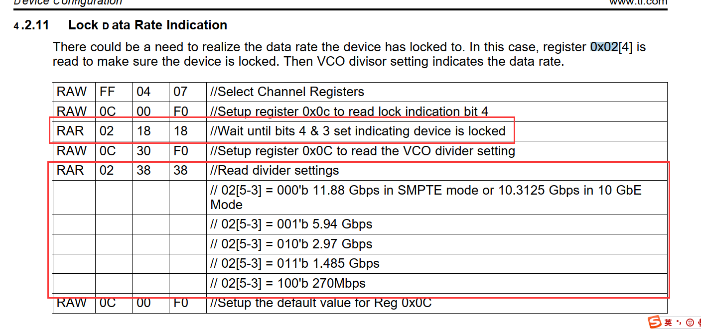

3:In the Programming Guide for LMH1218 (SNLS474), the register 0x02 describes a conflict, and the document describes bit 4, bit 3 as 11, which means CDR locked, and it says next that bit[5:3] means SDI locked mode.

    1). Please follow the link below to request LMH1219 updater. Once you install this file, you would be able to interrface with LMH1219 device as well.
    https://www.ti.com/drr/opn/LMH1219-DESIGN
    2). Programming guide is correct. Please note RAW 0C 30 F0 this command sets up reg 0x02 to specify VCO divider ration versus CDR lock status. Please note, at the end we have RAW 0C 00 F0 This enables reg 0x02 to read lock status.
