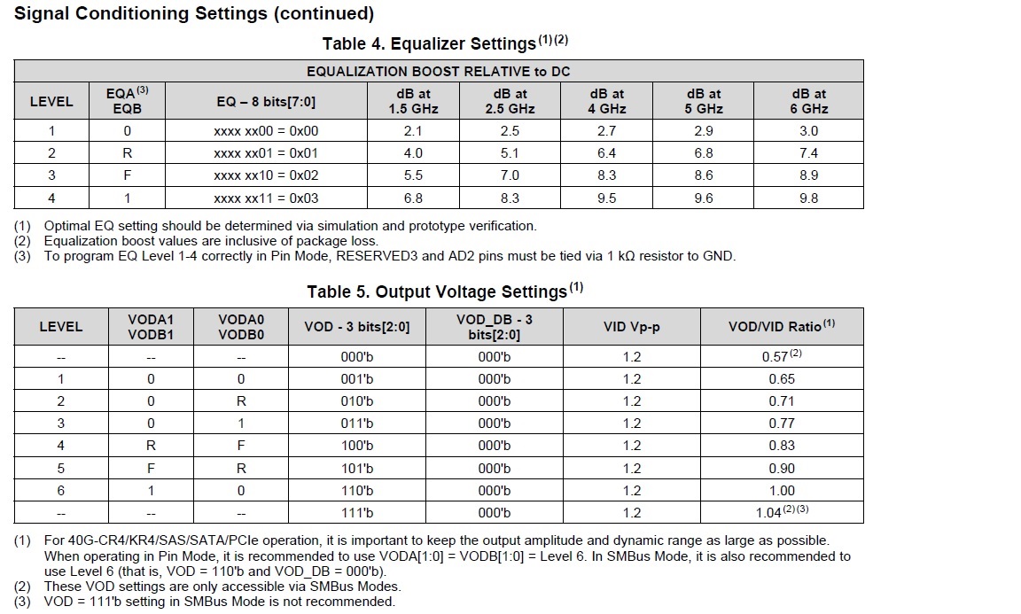

My customer would like to use 1 repeater to 8 receivers but 8 receiver devices have different distance from output side.
So we want to know whether it can be individual adjust equalizer and output voltage for each 8 channel?
Hi Jim,
The individual channels can be fully controlled with EEPROM or SMBus programming.
Lee
Hi Jim,
We have an IBIS-AMI model for simulations with the DS125BR820. I sent a link for the model to your email.
Lee
