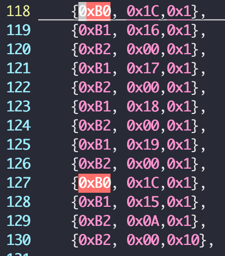

I study the  imx390_cfg.h which in PSDKRA_06_02/vision_apps/utils/sensors/src and DS90UB960-Q1 Datasheet now,
I found there is a lot of register control at 0xB0's related reserved register, like below.

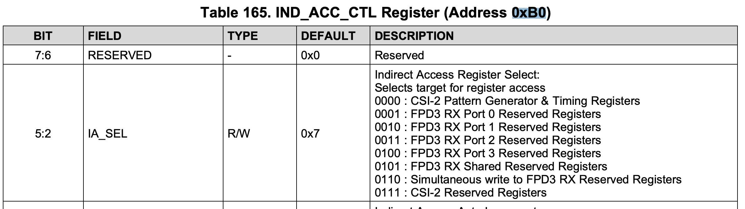

But after I compare DS90UB960-Q1 Datasheet,
There is no related describe about another reserved register, except 0000 : CSI-2 Pattern Generator & Timing Registers target,
Because we are trying to init  DS90UB962, but there is the some problem in DS90UB962-Q1 Datasheet.
Do you know where we can get related register descible?

  • Hello Sentinen,
    these registers needed to be written only in earlier samples of this device, but since it is already released to production (3 years ago), you do not need to write these registers.

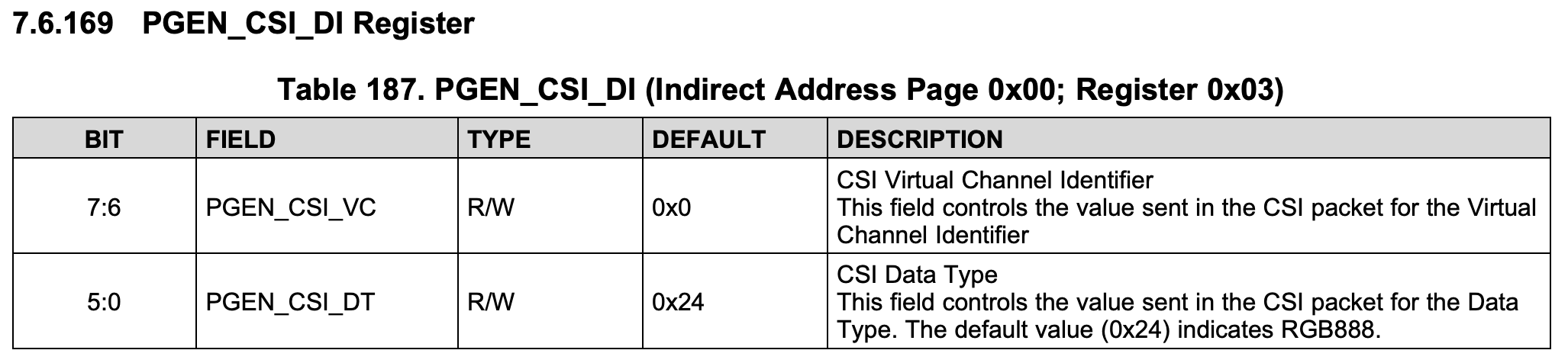

    Can you still provide us the detailed value describe of UB936's indirect Access Register 0x03 (PGEN_CSI_DI),
    right now I only know 0x2B is RAW10, 0x24 is RGB888,

  • Hello Sentinen,
    you can find all the Pattern Generator relevant registers in the UB936 datasheet, in section "7.6.165 Indirect Access Registers"

    As our work recetly, we can get capture data form UB962's CSIRX0 part,
    But we find there are some important register still need us to control,
    Below part is one of those registers control flow:
    {0xB0, 0x1C, 0x1}
    {0xB1, 0x15, 0x1}
    {0xB2, 0x0A, 0x1}
    {0xB2, 0x00, 0x1}
    The situation is not like your describe that we do not need to write these register,
    Can you provide us those registers detail describle?
    BR
    Sentinen Chen

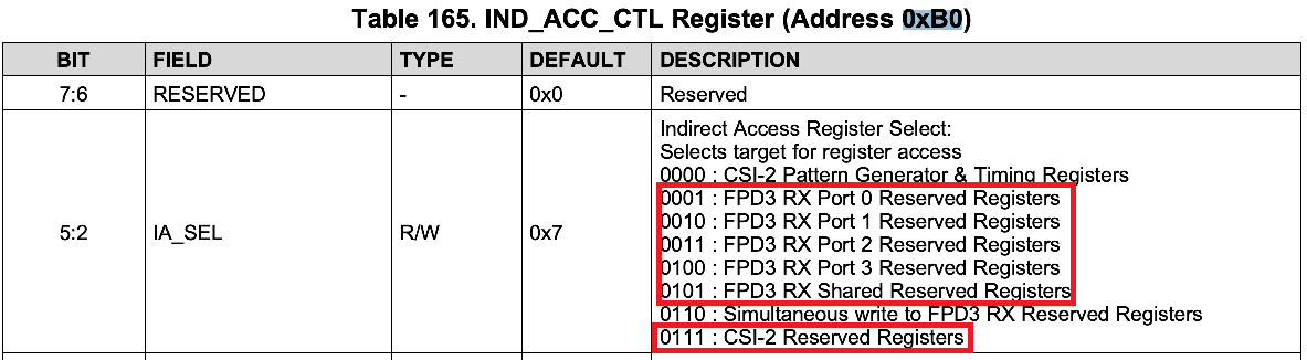

  • Hello Sentinen,
    Believe me you do not need to set any of those registers! These are not public registers and should not be used by our customers. These are just for internal use.
    Can you tell me what is the importance of setting these registers?
  • Hi Hamzeh:
    Just like my eariler post,
    {0xB0, 0x1C, 0x1}
    {0xB1, 0x15, 0x1}
    {0xB2, 0x0A, 0x1}
    {0xB2, 0x00, 0x1}
    If I didn't enter value 0x0A --> 0x00 to 0x15 register,
    then I can't see the UB962 start to transfer CAMERA data on CSI datalanes.

        {0xB0, 0x1C, 0x1}, /* Indirect Access Register Select:CSI-2 Reserved Registers */
        {0xB1, 0x16, 0x1}, /* Indirect Access Register Address Select: 0x16 */
        {0xB2, 0x00, 0x1}, /* Indirect Access Data Register: 0x00 */
        {0xB1, 0x17, 0x1}, /* Indirect Access Register Address Select: 0x17 */
        {0xB1, 0x18, 0x1}, /* Indirect Access Register Address Select: 0x18 */
        {0xB1, 0x19, 0x1}, /* Indirect Access Register Address Select: 0x19 */
        {0xB1, 0x15, 0x1}, /* Indirect Access Register Address Select: 0x15 */
        {0xB2, 0x0A, 0x1}, /* Indirect Access Data Register: 0x0A */
        {0xB2, 0x00, 0x10}, /* Indirect Access Data Register: 0x00 */

        {0xB0, 0x04, 0x1},/* Indirect Access Register Select: FPD3 RX Port 0 Reserved Registers */
        {0xB1, 0x03, 0x1},/* Indirect Access Register Address Select: 0x03 */
        {0xB2, 0x20, 0x1},/* Indirect Access Data Register: 0x20 */
        {0xB1, 0x13, 0x1},/* Indirect Access Register Address Select: 0x13 */
        {0xB1, 0x04, 0x1},/* Indirect Access Register Address Select: 0x04 */
        {0xB2, 0x3F, 0x1},/* Indirect Access Data Register: 0x3F */
        {0xB1, 0x14, 0x1},/* Indirect Access Register Address Select: 0x14 */
