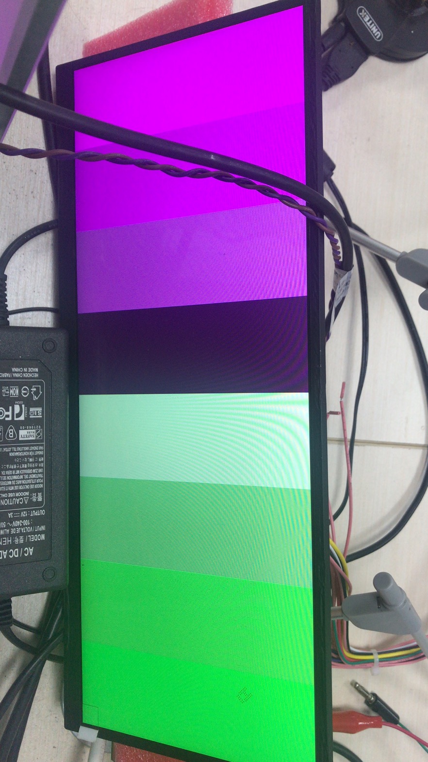

Hi Team,
When customer setup 0x64=0x35, the output color should be read/cyan. However, the display is not the color datasheet mentioned. Customer changed several formats but the colors are still wrong.

Hello Amelie,
That is because color bars overrides all the other selections from bits [7:4]. Please set 0x64[2] = 0 to use the other patterns
