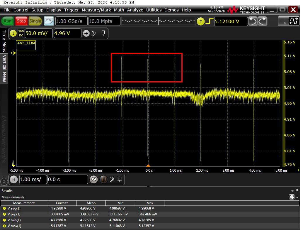

Hi
When measuring the VCC ripple (pin26) of TI_MAX3243EIRHBR, it was found that there was a lot of noise interference, resulting in a large pk-pk value
After bead ripple noise should be reduced, but the result is larger, is it the IC itself?

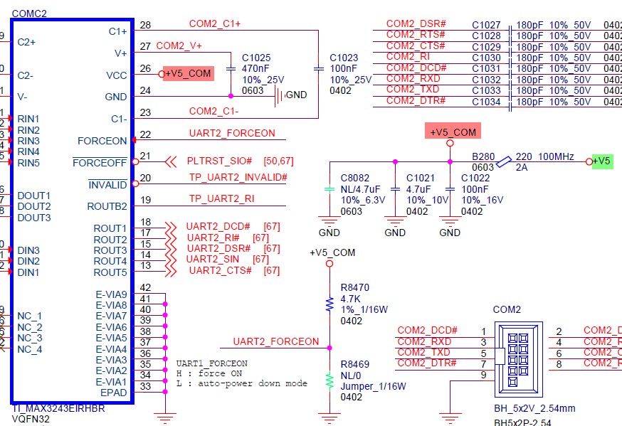

The VCC rail is used to power the device's charge pump, which generates the V+/V- rails by transferring charge between different capacitors. Because the circuit frequently charges and discharges capacitances, it can draw sudden current spikes from VCC. This can lead to ripple on the rail due to its non-zero source impedance (e.g., due to regulator output impedance and trace routing parasitics). Adding higher-impedance series elements like beads would worsen the ripple seen by the IC (but may improve the ripple as measured on the other side of the bead). You can read more about the charge pump operation and how different capacitor value influence the ripple in this blog:
Max
You could consider 1) reducing the sourcing impedance of the Vcc; 2) increasing the decoupling capacitor value. Sometimes deploying two cap, one large and one small, could help. In the layout, please make sure the supply and ground routing have good width. Also please place the decoupling cap, C1~C4 to the IC as closely as possible.
Hao

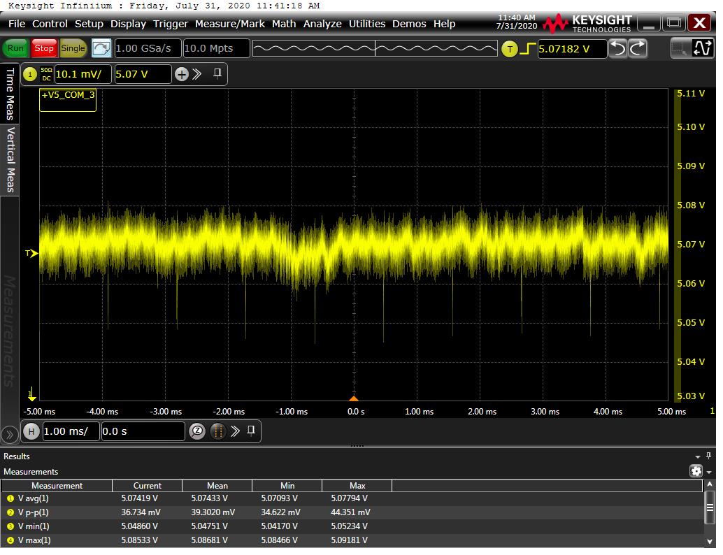

Hi Hao and Max
Why adding higher-impedance series elements like beads would worsen the ripple seen by the IC ?
Thanks for your update. I think the inductance of the beads makes the transient current more smooth but makes the transient voltage more sharp. You can compare the charge pump waveform between the two setup.
