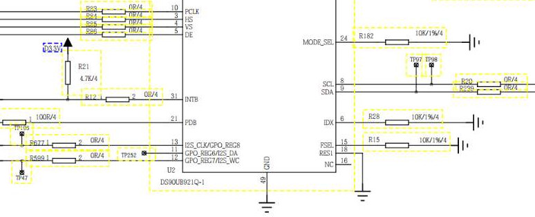

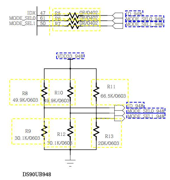

Hi Team,
My customer now use 921 and 948. The video could display normally. However the I2C communication has problem.
  • SOC could configure 921 register successfully.
  • SOC could not configure 948 register and has error. As the following log shows that SDA and SCL have been pull down to low...

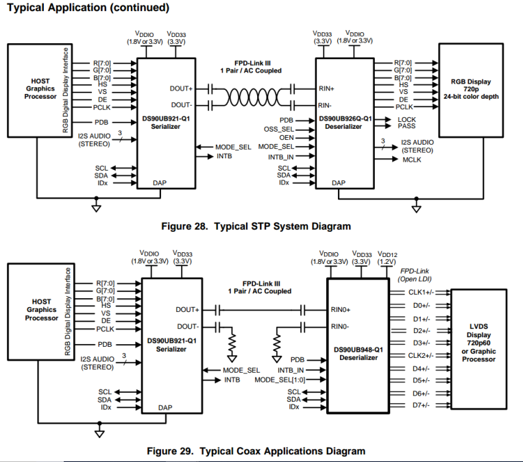

The following is the signal chain and SOC has 2 device connected.
SOC  -------   DS90UB921(0x0c)    ---FPD-LINK---     ----------- DS90UB948(0x34)   --------- Touch(0x20)
          -------   PCA 9654(0x24,GPIO expand)
The following is 921 and 948 configuration.

Are there any error about the configuration?
  • Hi Amelie,
    I dont see anything wrong currently, at what point are you seeing the error in the code? Can you send the addresses of the registers that you are writing in your code?Have you probed the I2C lines on the display?
    Michael W.
  • Hi Michael,
    Please see my feedback about these three question. Could you please kindly help? it is quite urgent in customer side.

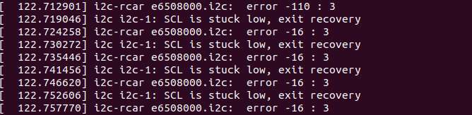

    1. At what point are you seeing the error in the code?
    When visit 948, it has I2C error.
    Here is Linux kernel log:
    [    2.022134] i2c-rcar e6508000.i2c:  error -110 : 1
    [    2.026932] fpd3_serdes 1-0034: Failed to read 0x00, Error = -110
    [    2.037269] i2c i2c-1: SCL is stuck low, exit recovery
    [    2.042413] i2c-rcar e6508000.i2c:  error -16 : 1
    [    2.047123] fpd3_serdes 1-0034: Failed to read 0x00, Error = -16
    [    2.057369] i2c i2c-1: SCL is stuck low, exit recovery
    [    2.062512] i2c-rcar e6508000.i2c:  error -16 : 1
    [    2.067222] fpd3_serdes 1-0034: Failed to read 0x00, Error = -16
    [    2.278128] i2c-rcar e6508000.i2c:  error -110 : 1
    [    2.282922] fpd3_serdes 1-0034: Failed to read 0x00, Error = -110
    [    2.293255] i2c i2c-1: SCL is stuck low, exit recovery
    [    2.298398] i2c-rcar e6508000.i2c:  error -16 : 1
    [    2.303106] fpd3_serdes 1-0034: Failed to read 0x00, Error = -16
    [    2.313352] i2c i2c-1: SCL is stuck low, exit recovery
    [    2.318495] i2c-rcar e6508000.i2c:  error -16 : 1
    [    2.323204] fpd3_serdes 1-0034: Failed to read 0x00, Error = -16
    [    2.534128] i2c-rcar e6508000.i2c:  error -110 : 1
    [    2.538922] fpd3_serdes 1-0034: Failed to read 0x00, Error = -110
    [    2.549255] i2c i2c-1: SCL is stuck low, exit recovery
    [    2.554398] i2c-rcar e6508000.i2c:  error -16 : 1
    [    2.559107] fpd3_serdes 1-0034: Failed to read 0x00, Error = -16
    [    2.569352] i2c i2c-1: SCL is stuck low, exit recovery
    [    2.574495] i2c-rcar e6508000.i2c:  error -16 : 1
    [    2.579204] fpd3_serdes 1-0034: Failed to read 0x00, Error = -16
    [    2.790126] i2c-rcar e6508000.i2c:  error -110 : 1
    [    2.794920] fpd3_serdes 1-0034: Failed to read 0x00, Error = -110
    [    2.804017] fpd3_serdes 1-0034: Not a fpd3_921to948_des chip
    [    2.809680] kfree memory fpd3_serdes_probe -- 618
    [    2.814405] i2c device fpd3_921to948_des : 0x34 disconnect.
    2. Can you send the addresses of the registers that you are writing in your code?
    Please see fpd3_serdes.h about the address definition.
    3. Have you probed the I2C lines on the display?
    When customer visit other device, such as 921, it is normal. However, when they visit 948, has error.

  • Hi Team,
    One more comment, I saw the 921 datasheet P43 that,
    when 921+926, it uses Figure 28. Typical STP System Diagram;
    when 921+948, it uses Figure 29. Typical Coax Applications Diagram.
    does it mean when use 921+948, only support Coax? Customer now use STP...

    The 921 can be linked to the 948 through a STP cable.

  • Hi Michael,
    Please see the feedback from customer side:
    • Can you send me a register dump of the 921 configured?
         0  1  2  3  4  5  6  7  8  9  a  b  c  d  e  f    0123456789abcdef
    00: 18 00 00 fa 80 00 68 40 40 00 00 00 00 00 00 00    ?..??.h@@.......
    10: 00 00 00 10 00 00 fe 5e a1 a5 00 00 00 00 00 00    ...?..?^??......
    20: 00 00 25 00 00 00 00 00 00 24 00 a0 00 00 00 00    ..%......$.?....
    30: 03 10 00 00 00 00 08 34 00 0a 20 21 00 00 f0 00    ??....?4.? !..?.

    • What are the MODE_SEL set to on the 948?

  • HI Michael,
    When connected to 921, it can't visit 948 register because meet the I2C error. But when connected to 949, it could work.
    The following I2C command have already used in customer system and all of them met I2C error.
             I2cdetect –l
             I2cdetect –y –r 1
             I2cdump –f –y 1 0x34
             I2cget –f –y 1 0x34 0x00
             I2cset –f –y 1 0x34 0x01 0x3f
