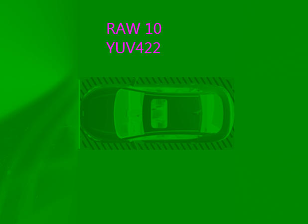

  • Hi Sally,
    Here is the display. The color seems strange. Which configuration do we need to change?
  • Hi Amelie,
    Can you read back register 0x4D, 0x4E, 0x55, 0x56, 0x0x7A, and 0x7B on the 936?
    Can you also send me this information so I can send you an internal pattern generation script?
    I need active vertical, active horizontal, frame rate, VC-ID, vertical back porch, and vertical front porch.
    Sally
