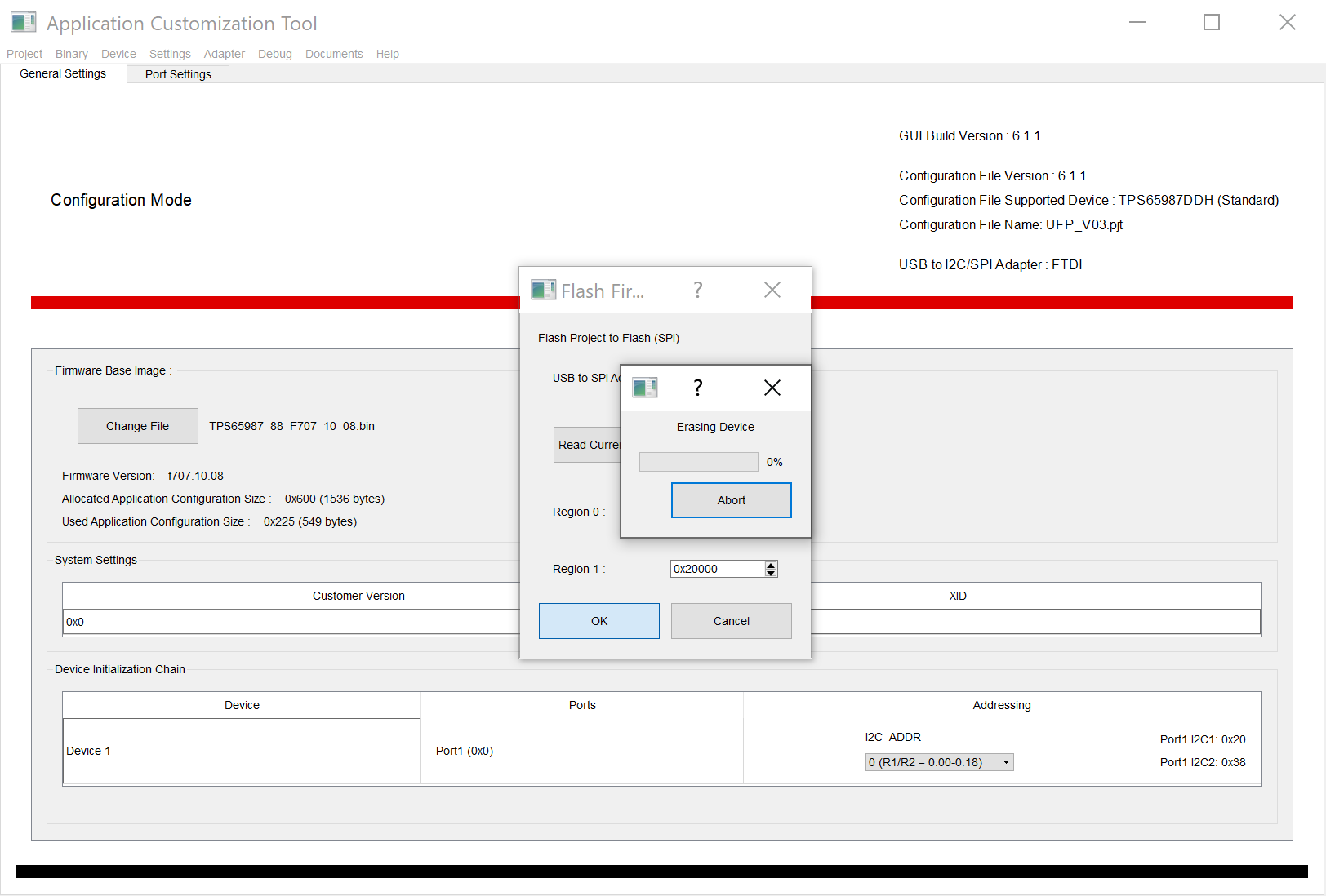

    We found that if the EVM board has a blank FLASH chip, the EVM board resets the same as our design (approx every 750ms). We are able to program a blank FLASH chip on the EVM board.
    When we try to program the FLASH chip on our design, the Configuration Utility starts to erase the FLASH and then "hangs" indefinitely (see pic). The progress bar stays at 0%.
    Have you seen this behavior?
    --Del
  • Hi Del,
    The picture can't be displayed. Can you upload it again by "Insert file" as below?
  • Here is the a pic of the Utility.
  • We found the problem. There was a bad solder connection on the FLASH chip (probably the SCK line).
    Thanks for your help.
