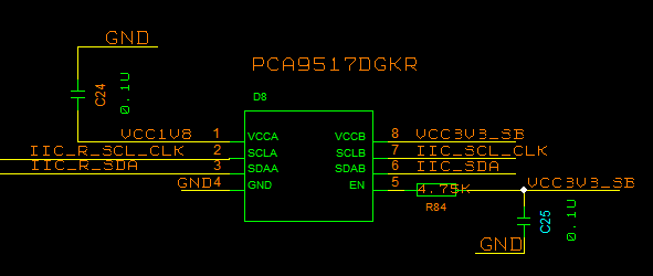

My customer has used PCA9517 in their system and met below issue, all boards see the same phenomenon:

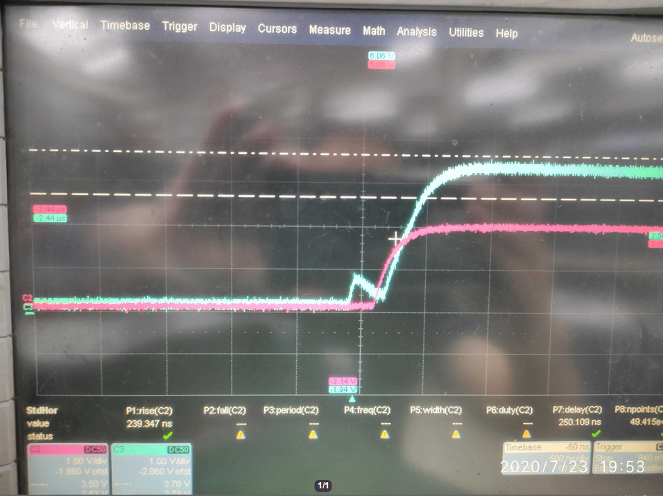

Blue curve is B side SCL, pink is A side SCL. SCL signal is sending from B to A direction. B side is master, 3.3V, A side is slave, 1.8V.

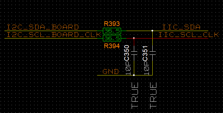

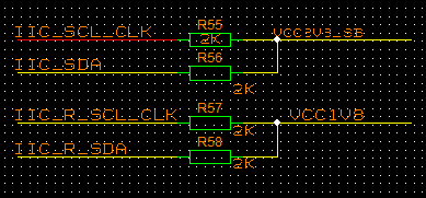

Have tried to change pull up resistor, didn't help.
If A side 1.8V is not on, B side SCL wave form is normal. If A side 1.8V is on, B side SCL wave form will become below abnormal one.
Customer also says if signal direction is A to B, no problem found.
Could you please help look at this issue?
Since PCA9517 is not recommended in new design, can we promote TCA9617 to replace? Customer also has TCA9617 AVL code.
Below is the schematic:
Thanks a lot!

    [Bobby] So it looks like this is caused by the "unwrapping" effect of the 9517 (occurring when B side releases low and A side is not driving low). A side needs to go above a certain threshold (I believe ~40% of VccA) before B side will fully release(otherwise A side will temporarily drive B side to ~540mV) I suspect you can minimize this overshoot be making B side's pull up resistor weaker/larger and making A side's pull up resistor stronger/lower. If the customer can modify their resistors to minimize the glitch to be less than 50ns, then there shouldn't be a problem (I2C spec dictates all slave inputs must have a 50ns deglitch filter built in.)
