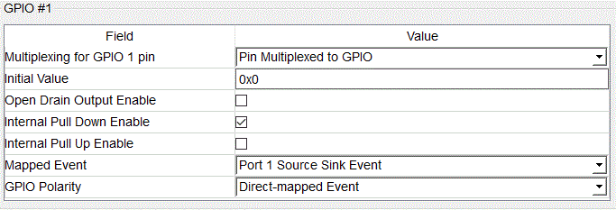

This is how we believe such GPIO1 ought to be configured:

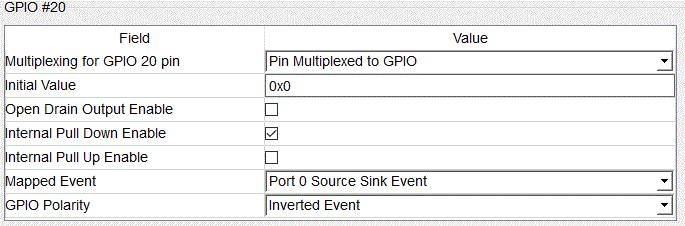

This case is corollary to https://e2e.ti.com/support/interface/f/138/t/927370  (TPS65987D: Port 0 Source/Sink GPIO event unexpected behavior) where issues have been uncovered with such configuration and particularly when another port (GPIO20) is configured similarly but with opposite polarity for use in another circuit portion in our design.
Such GPIO20 is configured as follows:

    This makes me believe that when nothing is attached on a DRP port controlled by the TPS65987D (and is desired to be able to connect to a sink device), the BQ25713 needs to be configured and enabled in OtG mode such that the TPS65987D sees such 5V and then it be willing to offer Ip (during the DRP "dance").
    I'd consequently reckon that my GPIO1 configuration needs to be slightly (and dynamically) modified such that it has a Pull-Up resistor when the system wants to host sink devices (typically when the system is in an On & Ready state) and have a Pull-Down (or set to a hard Low) when the system doesn't want to host sink devices (typically when the system is in an Off state and is desired to save power by the BQ25713 not running).

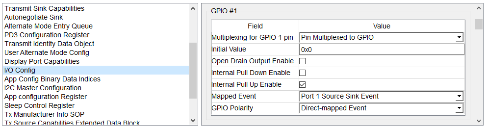

    I gather such GPIO configuration shall look like this:
    Which differs from my original suggestion in that now I enable the Pull-Up instead of the Pull-Down resistor so OtG mode is the default if nothing's attached.  However please check if the Initial Value shall be 0x0 or 0x1.  I have 0x0 as I think it's safer to have the BQ25713 initially as a sink and once things settle from Reset normal operation follows, but please correct me if I'm wrong!

  • Hi Georg,
    Yes I think that GPIO configuration looks correct.
