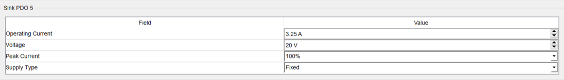

  3. I configured sink 100W, but PDO5 only shows 3.25A operating current not 5A, is that OK?

    3. No this should say 5A. We will add this to the list of items to update in the GUI. We are releasing a new version of the GUI soon, and will make sure this makes it on the list of what to update

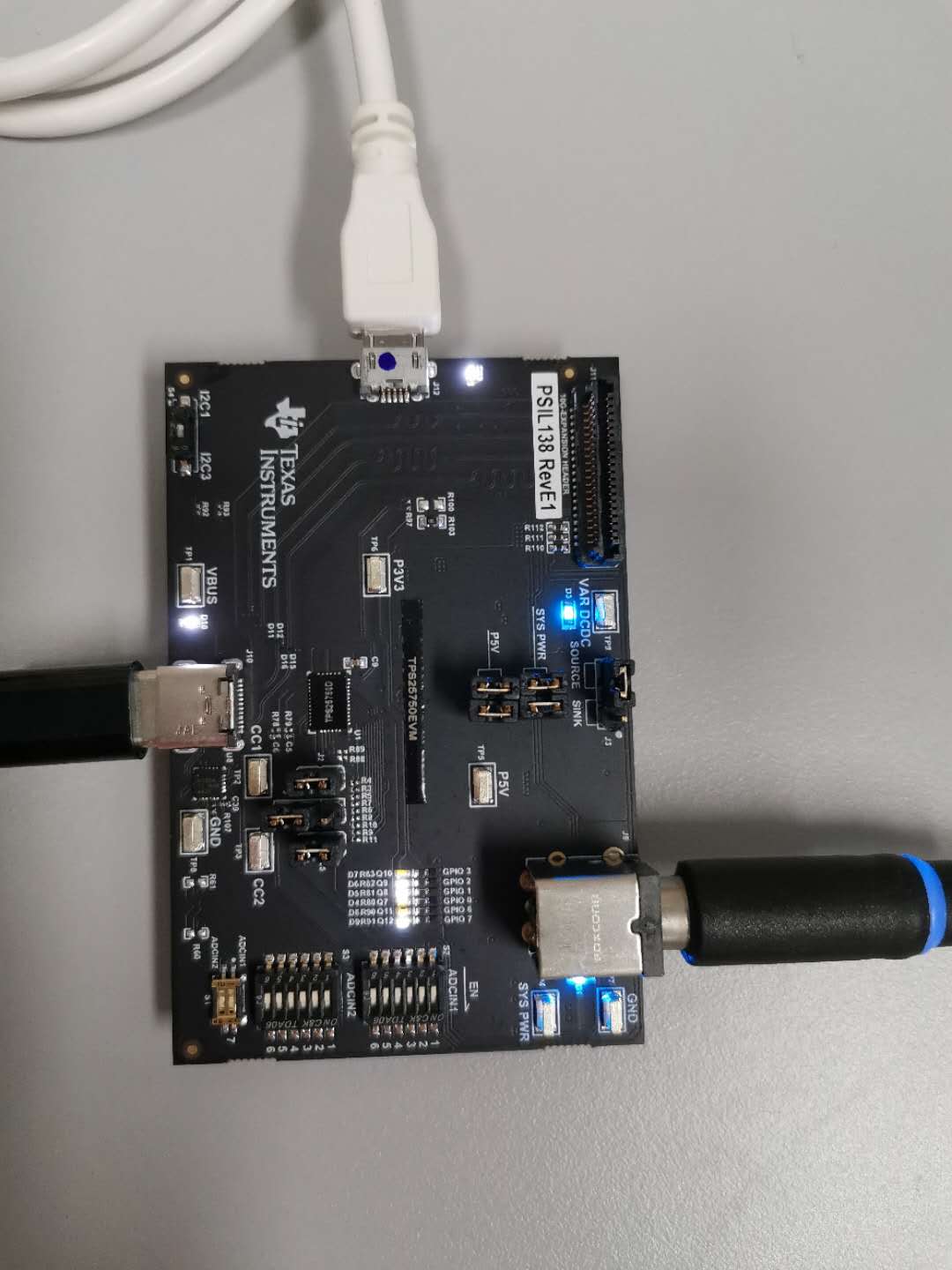

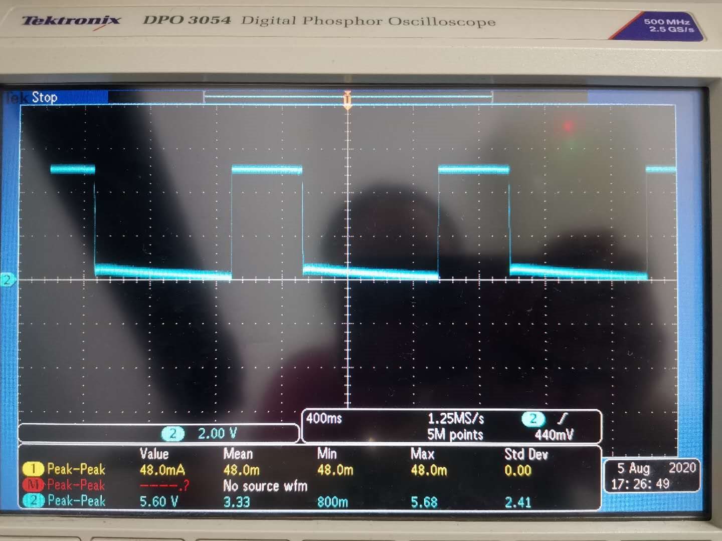

  • Hi Adam,
       I got TPS25750EVM and tested it. But met an issue need your help. The project file is as attached.
    7558.SOURCE18W_SINK100W_TEMP.zip1. Sink function is OK, I can see VBUS got a 20V voltage.
    2. Source is not OK when charger a mobile phone.
    1) D5, D6 and D10 are blinking. P3V3 = 3.3V, P5V = 5V, SYS_PWR = 20V.
    2) The waveform of VBUS is as below, never negos to 9V, which is not correct.
    3) Use the same mobile phone + the same wire + TPS65988EVM, it's OK to get 9V@VBUS.
    3. EVM HW set up are as below:
    How to get 9V output as expected when acting as a source?

  • Hello Holly,
    I answered this question in the new thread that you posted
    https://e2e.ti.com/support/interface/f/138/t/929503
