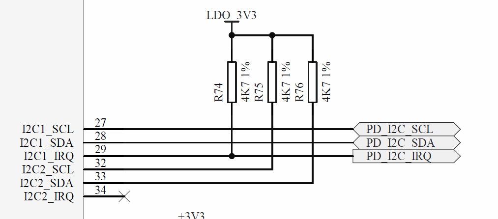

  • Hi Chamira,
    Do you have an external 10K pullup resistor connected to the IRQ pin and LDO_3V3?
  • Hi Adam,
    Thank you for your reply. We have a pullup on I2C1_IRQ which is 4K7. Do you think this is not sufficient? I've attached the relevant portion of the schematic to the reply.
    Kind regards,
    Chamira.
  • Hello Chamira,
    Based on the schematic you shared, you do not have any pullups on I2C1_SCL or I2C1_SDA. Are you communicated to the PD controller only on I2C1? If so do you have a pullup elsewhere on your schematic?
    If you do, would you be able to share with me the I2C transactions being sent between the devices using a logic analyzer of some sort
  • Hi Adam,
    Sorry for not being thorough, the design has two other I2C slaves on the I2C bus and the pullups for the I2C lines are on a different page of the schematic. The design is using 4K7 pullups for the I2C bus.
