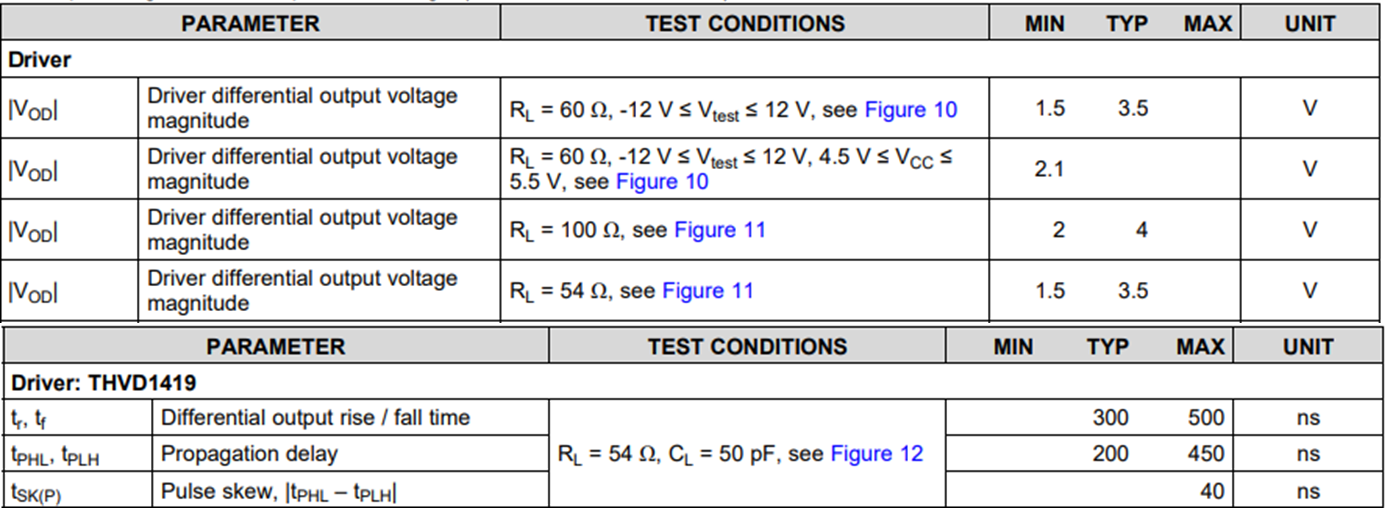

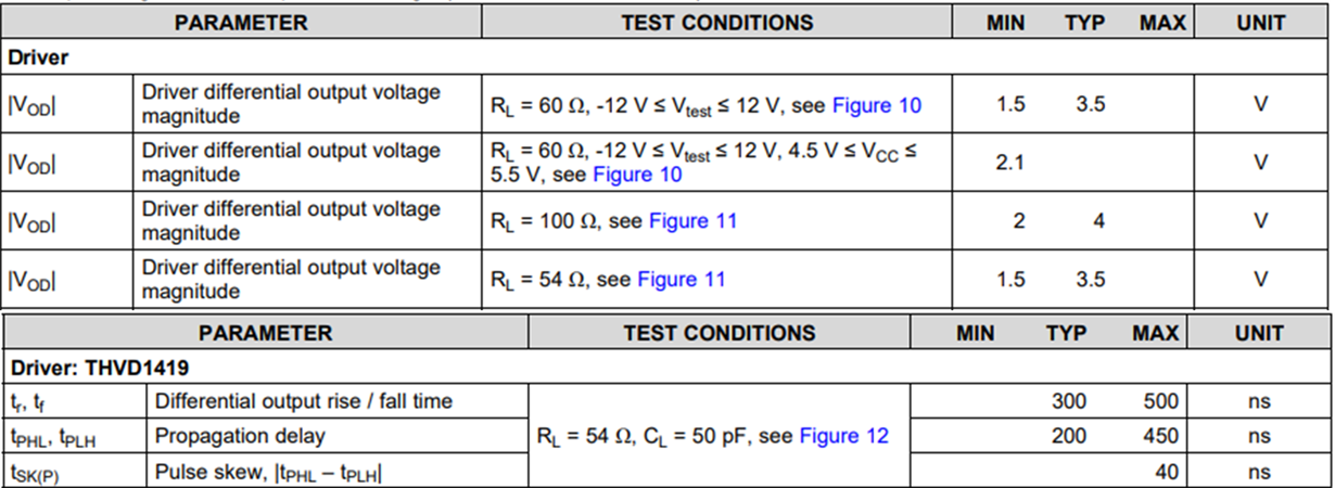

Does THVD1429 have specs of slew rate at A, B bus terminal?
There are no specification so I want to know practical value.

Asaishi-san,
Slew rate could be derived based on the output differential amplitude (VOD) and rise/fall time (tr/tf) specifications. You could compute it as 0.8 * VOD / tr. The 0.8 factor is because the tr (or tf) specification is measured based on 10% and 90% amplitude thresholds.
Max
Koyo-san,
The typical tr/tf with a 54-Ohm load ("worst case" load for RS-485) is 300 ns. The typical VOD for this condition is 3.5 V. So, the slew rate would be 0.8 * (3.5 V) / (300 ns) = 9.3 V/us.
Max
