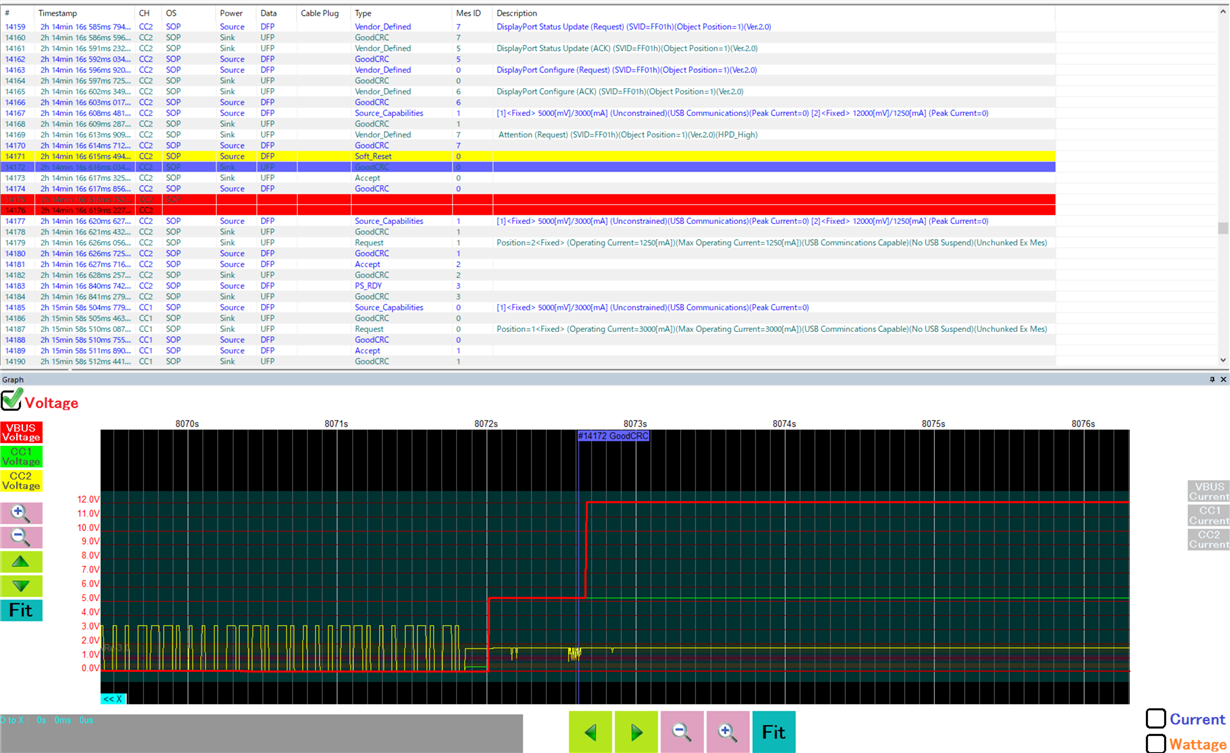

This is capture of PD negotiation.
TPS65987D send HPD-high attention message right after receiving Source cap.
After that, Host send soft reset, and TPS65987D accepted it.
I think Host sends soft reset message because TPS65987D violate PD spec.

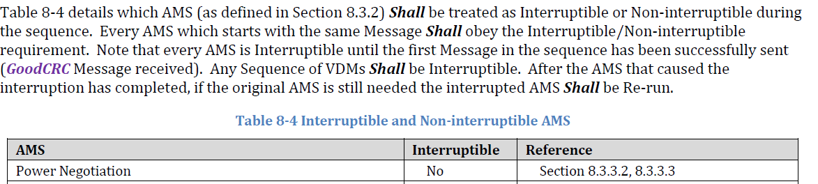

According to PD spec, Power negotiation is not interruptible.
So, TPS65987D should send HPD-High attention after PS_READY(12V), or between DP_Configure and Source_cap(12V)
This situation occurs several times every 1000 times.

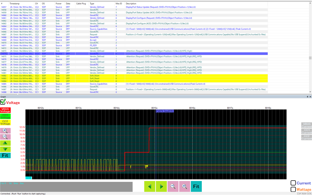

The below picture is PD log of desired situation.
Tthere is only about 5-10ms between DP_Configure and Source_cap(12V).
I think TPS65987D receives Source_cap while trying to send HPD-High, and TPS65987D looks like to fail to interrupt message transmission.
