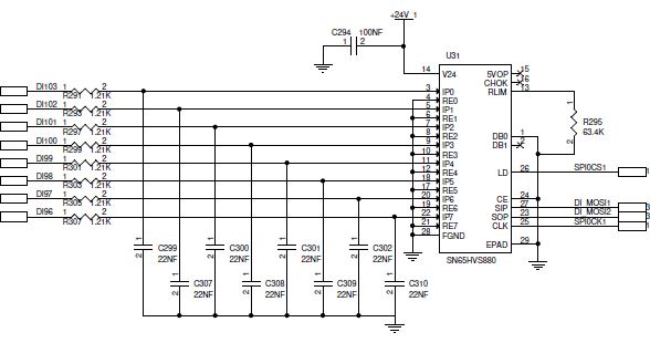

How to calculate device power dissipation for different values of  Rlim ?. Worst case power dissipation in data sheet is 2591mW is quite higher. Is there any ways to reduce this by increase Rlim and load currents
In my circuit, Rlim is 64.2kOhm, limiting the input current to 1.4mA. What would be the power loss of the device in this case ?

  • Hi Parker,
    Thanks for your quick reply and detailed explanation. As requested, I attached draft circuit for your reference.
    Initial Operating Ambient temperature is 40 Deg C and will increase to 60 Deg C during running condition due to the heat dissipation of other components around it.
    Please provide us the heat dissipation with the conditions provided.
    Gowri
  • Hi Parker,
    All DI's are connected to 24VDC supply.
    Gowri
  • Hi Gowri,
    Thanks for the detailed follow-up. I can give you an estimated power loss, but there are quite a few non-linear parts so it is more of a ballpark range then an absolute value.
    P_loss_Rlim = 1.25^2 / 63.4k = 24.645 uW
    P_loss_IPx = (24V - 1.4mA *1.21k) * 1.4mA = 31.228 mW
    P_loss_supply =  (24 -5) * (Iout + Isupply) = 19 * (8.7mA) =  165.3mW - 8.7mA is worst case supply current with similar set-up to your system
    Approximated Max P_Loss For system = P_loss_Rlim + P_loss_IPx * 8 + P_loss_supply ~ 415.15 mW would be my rough estimation of max power loss. The resistors before the IPx inputs help reduce power loss through the device, as well as the lower current limit. Since you have no load off of the regulator you wont be burning as much power through the regulator, since it isn't terribly efficient.
