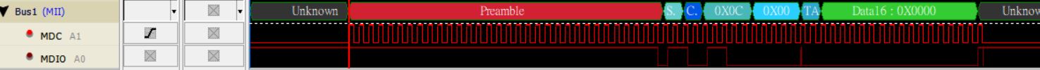

  • Dear Justin,
    I capture waveform for you.
    Case1:
    capture register 0x1~0x5
    Zoom in package #1
    Zoom in package #2
    Zoom in package #3
    Zoom in package #4
    Zoom in package #5
    Case 2:
    Capture register address 0x0~0x05
    zoom in package #1
    zoom in package #2

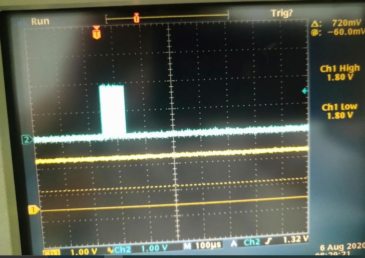

    The MDIO is running and check the voltage.
    capture 1.1V and MDC
    capture 1.8V and MDC
    capture 2.5V and MDC

  • Hi SJ,
    I'm sorry for the delayed response. I suggest using a released MDIO communication tool to verify the electrical connections on MDC and MDIO pins. The intermediate voltage shows where the PHY is expected to provide data suggest there is some contention on the MDIO output. The voltage is neither pulled high when the PHY would be inactive or to Ground when the PHY should drive low. Is the FPGA configured to accept the data the PHY provides during each read function?

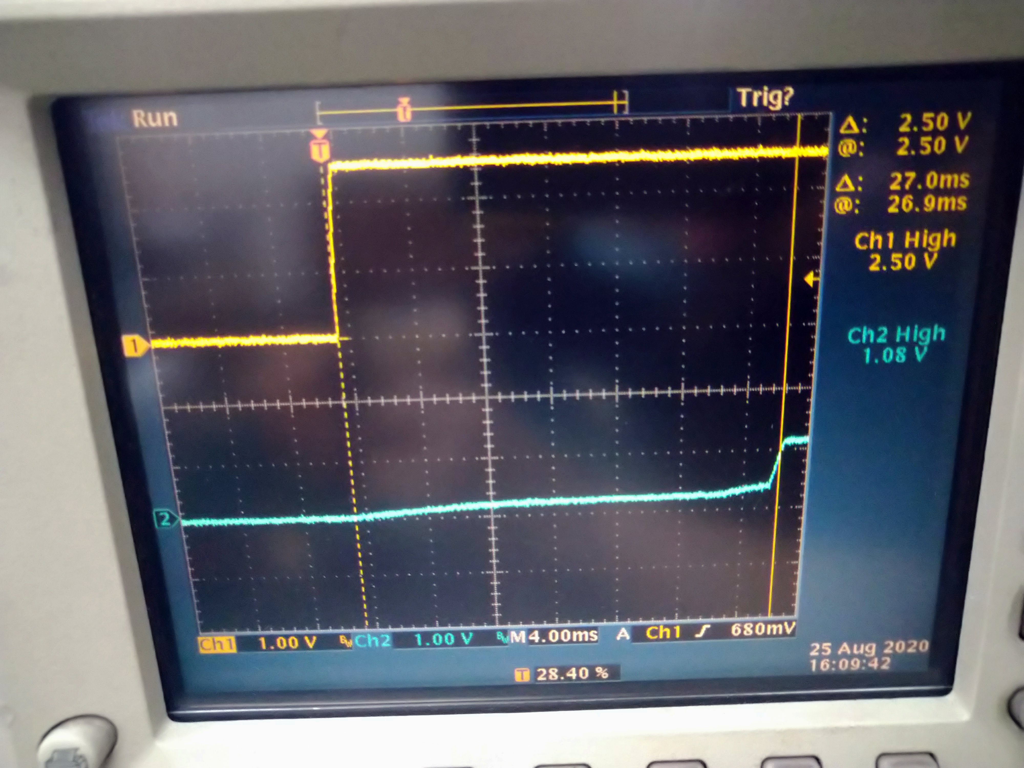

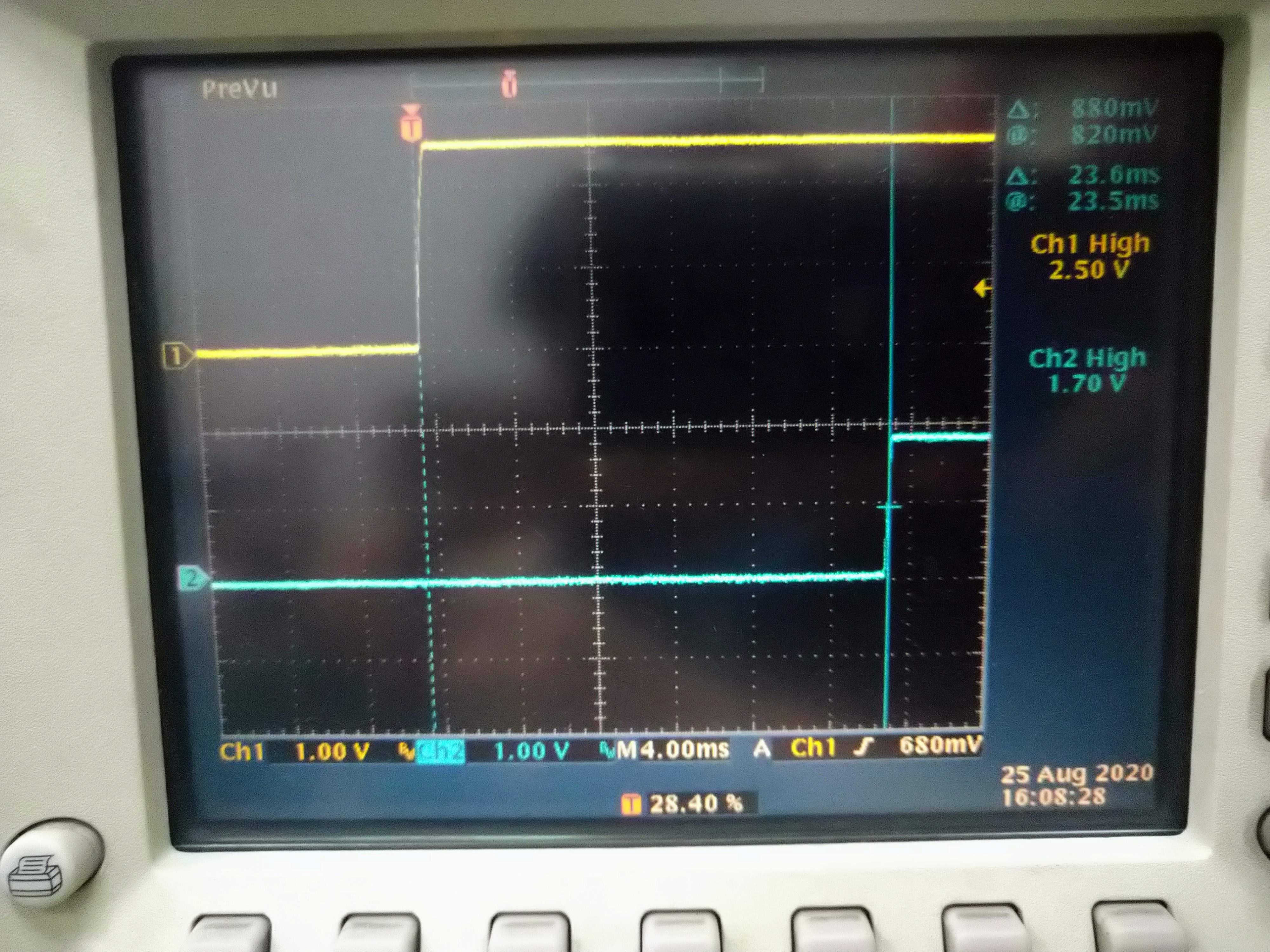

  • Dear Justin,
    I  check the power follow as:
    2.5V(VDD2P5) -> 1.8V(VDDIO) is 23.6ms
    2.5V(VDD2P5) -> 1.1V(VDD1P0) is 26.0ms
    I check the datasheet on page 124. The datasheet has highlighted as "There is no requirement for the sequence of the supplies when operating in two-supply mode."
    What's the correct power sequence?
