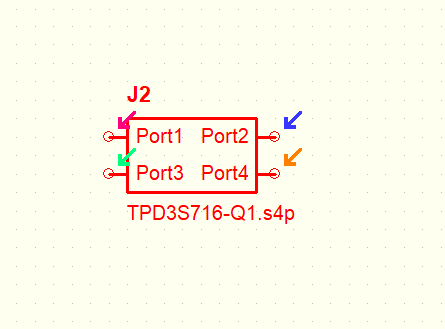

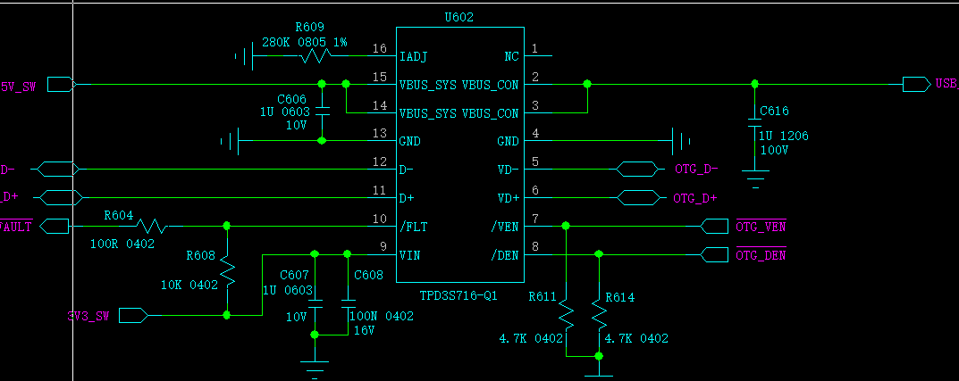

We used a  TPD3S716-Q1 in our design and I downloaded the IBIS model from TI website.

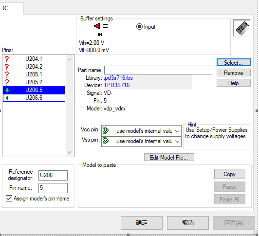

Now I want to do fasteye channel analysis  for USB D+/- nets. when I assign IBIS model to TPD3S716-Q1 ,D+/- ,VD+/- can only be assigned as input.  In my opinion, one group should be assigned as input, and the
other group should be assigned as output. And also on the datasheet, all these pins are I/O type.
So I can't finish the simulation to USB data line.
