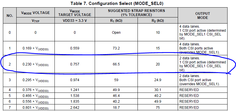

Hello Team,
Our customer want to set #2 of the MODE_SEL0.
They plan to use R1=162K, R2=47K resistor. So 47/(47+162)=0.224.
These resistors is larger than the suggested value. Is there any problem?

Hello Yuta,
they can use any resistor they want, important is to maintain the Vmode Voltage specified in the table with +/-1% tolerance.
