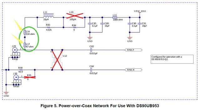

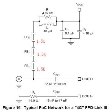

DS90UB953-Q1: Ferrite bead in PoC network
Part Number: DS90UB953-Q1
Hi Team,
DS90UB953 datasheet recommends three 1.5k ferrite beads shown in figure 16, however, 953EVM recommends one 330Ω and one 47Ω ferrite beads, could you please help advise which one should be followed?
Is there any document about the PoC network design?
Thanks and Best Regards!
