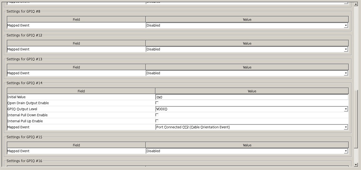

We have a tps65982 connected to HD3SS460 for DP-alt-mode muxing. Can you indicate how to configure the GPIOs in the tps65982 firmware to handle DP-alt-modes C, D, E, F when HD3SS460's EN, AMSEL and POL pins are directly connected to tps65982 GPIO 0, GPIO 3 and GPIO 14 without any pull ups or pull downs? SBU is directly managed by the tps65982 and not routed to HD3SS460.
Does the attached setup look correct?
