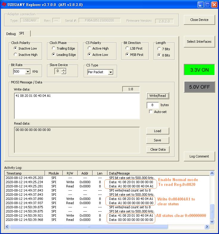

I use Ti's tool "USB2ANY" output SPI command to control TCAN4550EVB.
TCAN45xx Software User's Guide example setting  from
(1)"Table 7. Message RAM Design Example Register Values"
(2)Table 17. SPI Writes
My problem is
(1)Why the value of TXFQS's value is not (Address 0x10C4) 0x0003030A ?
(2)Why the CAN_H and CAN_L don't output signal ?

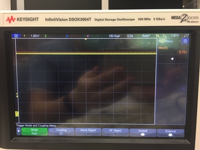

    • Can you confirm the device mode by probing the INH pin?
    =>When INH pin is in normal mode,Its voltage is 5.75V.

    • My register is set as follows:
      Power on to Read Register 0x0820, the value is 0x00500081 and 0x00500089
      0x0824=0x00000000
      0x0800=0xC80004A8 =>setting to Normal mode
      0x1018=0x00000303  =>Enable FD and Bit rate switch
      0x101C=0x00022008 =>setting CAN Speed to 500K
      0x100C=0x00010F50 =>setting CAN FD Speed to 2Mbps
                When I enabled Normal mode, I try to read 0x0820,the value is 0x004004A1.
    => CAN silent and CAN Error  bits will to be "1". Why ?
    I try to write register 0x0820 0x004004A9, then it can be clear to 0x00000000.
    I followed  TCAN45xx Software User's Guide  section "4.3 Sending and Receiving CAN Messages".
    But there is no any output from CAN_H and CAN_L.
    Are there any other settings I need to set ?
